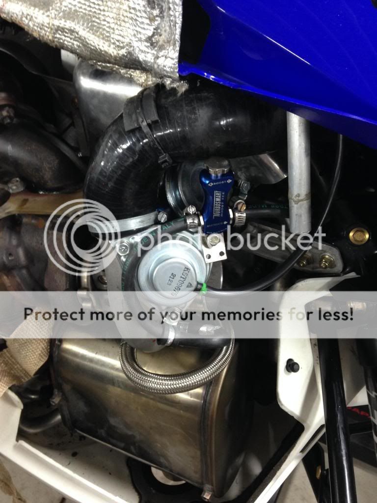

Here is my manual boost controller if it shows up in the picture.
