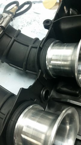

installing my kit today- does part #5 the flat plate stay in with the kitz? i dont see to remove it in the instructions, http://www.highlandsyamaha.com/oemparts/a/yam/5601882e87a86615687b13bb/intake

Yes you need itinstalling my kit today- does part #5 the flat plate stay in with the kitz? i dont see to remove it in the instructions, http://www.highlandsyamaha.com/oemparts/a/yam/5601882e87a86615687b13bb/intake

Thanks for the great pics!

Great pics martyv
