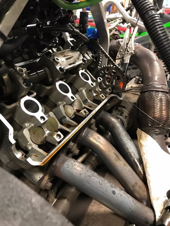

Long time since I posted here, dealing with my father’s 14 viper, it has just shy of 20,000 km’s. This sled never started right from day one in my opinion but you get to learn the tricks. Anyways, last year on his last trip he started having cold starting issues that were way worse than before. Won’t stay running without throttle when cold and when coming to a stop it was stalling. A few people I have talked to have said to check the valves, a few dealers have said to check the valves, Yamaha Canada said to check the valves. Background, I’m an automotive service technician. I pulled the valve cover tonight to check clearances, with the minimum exhaust spec. Being 0.083” I can put a 0.008” feeler gauge on all 12 buckets and they fit, with resistance as they should, but they fit. I can spin the buckets on the valve so they are not tight. Any ideas?? Seems like an idle air control problem to me, I don’t feel like dropping $1400 plus tax on a complete throttle body (can’t buy IAC separate) on an educated guess.

I can now share the details on how Lighthouse Motor Sports made sure the tensioner did not move when removing the cams. I first had to ask them permission out of respect for them. They opposed the tensioner spring by wiring up the cam sprocket (see photo). In the middle of the two strand wire loop was a long bolt that they used to twist the wire. The twisted wire acted as a turnbuckle. This retaining method allowed them to remove the cam without moving the tensioner or the sprocket. All this is detail compared to the idea of making sure the tensioner did not move when removing cams. That idea came from a member of this forum after being spurred on by me saying it was possible. This all happened last night but then again I said it was possible seven months ago.

I did my nytro before winter. 24k mi and all ex were 1/2 clearance. intakes were fine. I did cheat by rigging the sprocket and not touching tenssioner. sucked leaving apart for a week waiting on shims. dealer "never heard of it" and thought I was an idiot for doing valve maintenance. 6 shims were like $150

Well I just put final bolt in after Spring project of a valve adjustment. All the intakes were fine, and all exhaust valves needed attention. Two of which I couldn't even measure, smallest feeler gauge was .002". So I ordered all exhaust shims from Yamaha ($9 each) I guess -.010" for the tight valves and I guessed correctly. I bought a few extra shims that were -.012" from what was in there. Well cranked sled over with switch off to get oil pressure to tensioner. Then hit kill switch and started like a charm. No leaks or missing bolts. Still not sure if this will fix my cold start issue, since its 60 degrees here. O 'well i'll wait until October. At least I can eliminate that valves need adjusting. All valves are perfect now. Big thanks to cannondale27 for advice. No special tools needed except Service Manual. Not sure time it took, worked on it few hours here and there after dinner. Anyone need advise on doing this job, hit me up. (did it with motor in sled)
