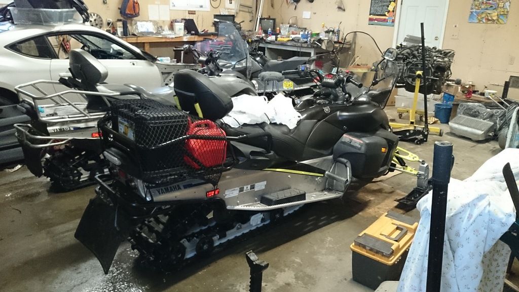

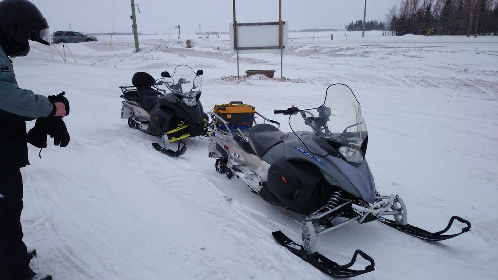

I currently own two 2009 Venture Lites (which appear to have a number of MP upgrades) that were used as trail groomers (Edit - they were actually trail monitoring and maintenance, and only pulled a small sleigh, I clarified this with the first owners). They have been great fun and have a unique handling experience.
The only problem I have, is I occasionally bottom them out on large jumps/drifts. I was wondering what sort of longer/firmer suspension is available for them? I suspect something made for a Phazer or Nytro would fit the front and rear suspension. Has anyone done such an upgrade?
Couple of pictures of the 2, and the MXZ.

At first glance, I can tell they are Lites because of the passenger foot rests. In that case, you already have the stiffer springs compared to the early MP's. What MP upgrades do you think these sleds have?
Two things you can do. Turn the front 2-up spring block up and turn the rear spring block to the stiffest setting. Even that may not be enough. I bought some aftermarket spring adjuster blocks that has two higher settings. I have mine at the 4th highest and it's perfect for my 340lbs. carcass. Unfortunately, I can't find the maker/seller of the ones I got about 3 years ago and trying to find the other brand X-Clicks, I get dead ends and "no longer available". Anyway, try the stiffest settings and see if they help.

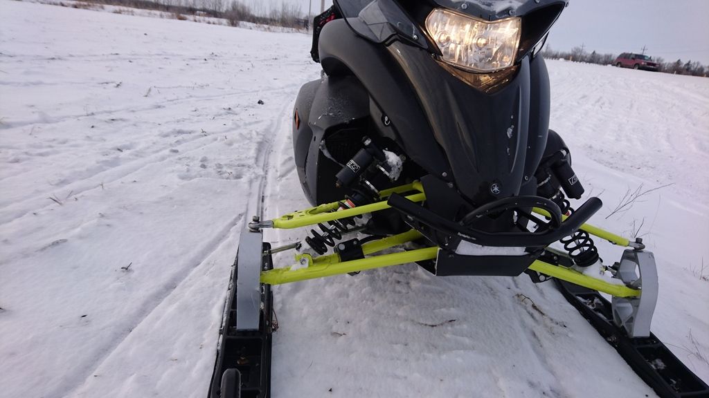

So last year, I acquired some GYTR front shocks for the Venture. I can't recall now what they were off of, but I think it was an Apex. They were not the simple fit type of a Phazer for sure. The lower mounts were about 1cm wider than the Venture arms would accept. At the time, the easiest way was to just grind down some of the material on the shock mount to fit. However, this allowed me to note a new problem - they were much longer. So long in fact, that I couldn't install them with the springs seated. For the time being I backed off the adjusters which allowed them to just fit at maximum suspension droop.
Driving impressions with these were good in a straight line, but cornering became a problem as the front end was now raised to an unusual height, and I had about the same overall travel as before.

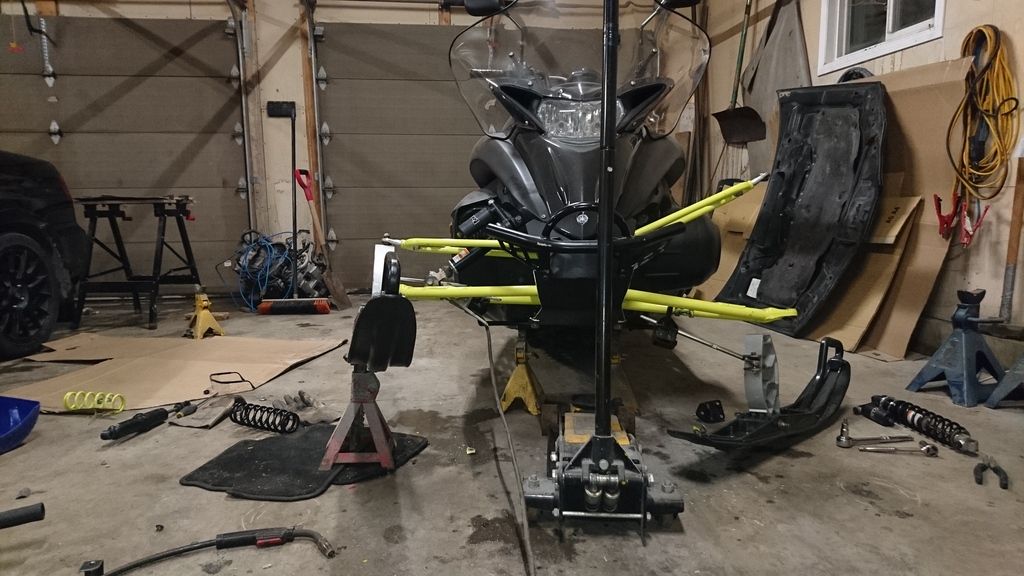

So this year, I endeavored to relocated the shock mounts on the A-arms allowing the shocks full range of travel and keeping the ride height low enough.
With everything disconnected, it became an X-wing venture.
It really seemed a shame to cut into the arms, and ruin the paint. Eggs and such...

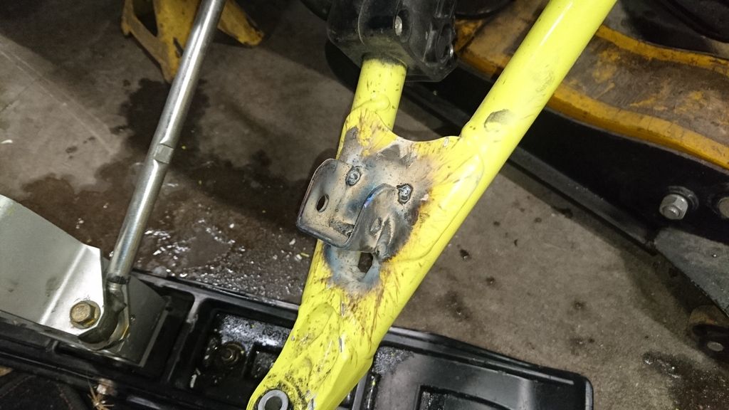

To fabricate a new mount, I used some flat plate, cut and bent to replicate the shape of the old mounts. I also made them wider so the full width of the lower shock mount could be accepted. No more Venture shocks for this setup.
The mount was also moved outwards about 1.5cm which allowed the shock to be installed at full length with travel to spare.
This is was measurement I was basing most of this off of. I wanted the skis to be almost level with the belly pan at full compression, yet extend far enough to utilize the full range of travel when landing after a jump. There is about 2 inches more movement than shown in this picture, and also the bump stop.
Once everything was repainted and reassembled this became the standard ride height for the front. It could probably use a little tuning to get the most of these shocks, but the handling and bump absorption is much improved.
