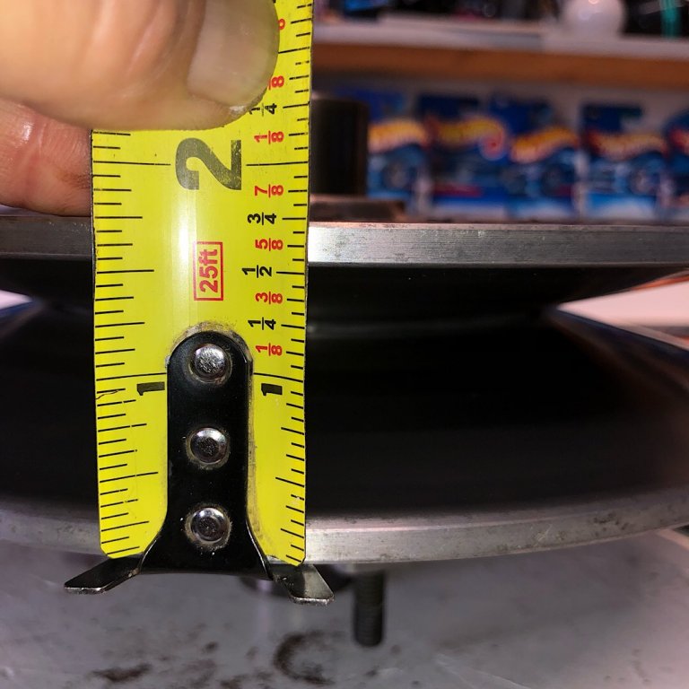

Pulled my secondary (YVX MOD) not stock to be clear.
Things I noticed was the amount of play in the bi metal bushing/shaft on the inside sheave (closest to motor) Don’t remember it having that much. Taking the helix and inspection of the bushing (which is the same part number as inside sheave hushing) I can clearly see a bevel to it. Inside sheave there is now Bevel. Assuming it’s worn out.

Measure the pics of sheaves pinched together then pulled apart by hand just to show play. Also helix bushing shows some new rough spots in it. Can feel the gouges.

Cover one is for sure wore. The bimetal one although scratched doesnt look to be wore. How about the upper wheels? Could that be causing the vibration?
- 5,714
- 4,312
They don't look wore very much. I check these with the spring out and clutches bolt together. IMO you need to see the Teflon coating gone in order to consider replacing.

I put everything back together. The 1/8” play in secondary turned into 1/16. Don’t think that was it. Either way was a maintenance item I didn’t mind doing.

425km trip today and not a single vibration at speed. Secondary bushing I’m going to say was definitely it. (Helix I left alone)
