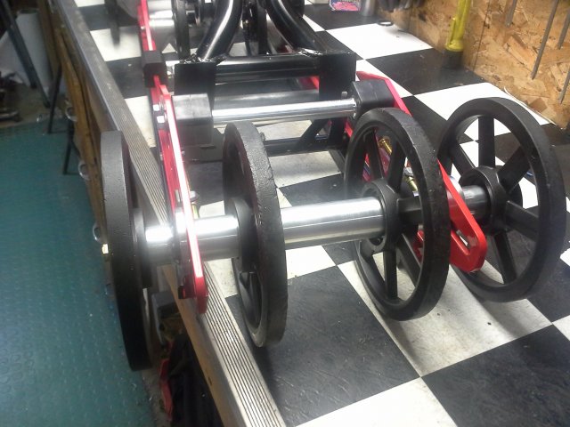

I just bought wheels and made the bushing and axle got rid of the tri hub View attachment 117657
Be careful with those composite wheels you have there. They can break and cause track damage. Studs will wear them in a few years and the tread part of the wheels will get holes in it because there is a hollow channel inside of the wheel. J&T and Turbo Dynamics quit selling them because of those problems. TD will sell you them if you ask but will recommend that they only be used for drag racing.
