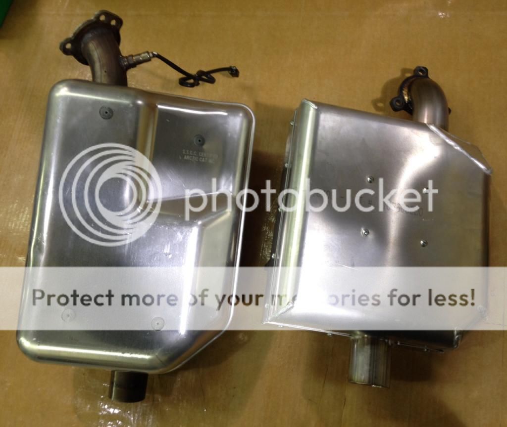

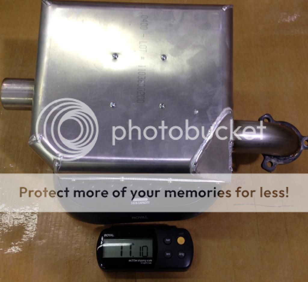

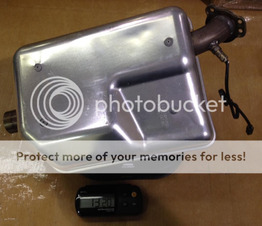

I weighed a stock muffler to compare it to our muffler that will come with the turbo kit. I had some critics ask why would we use such a large muffler on a turbo kit? Because some of you guys ride in areas that have sound restrictions. For those who don't, we'll have a light weight version available. The stock muffler 13.2lbs. vs ours 11.1lbs. Our muffler has a little more deep tone to vs. the stock one.

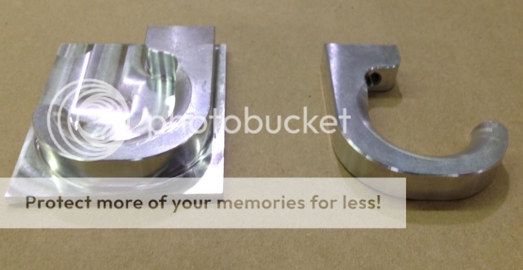

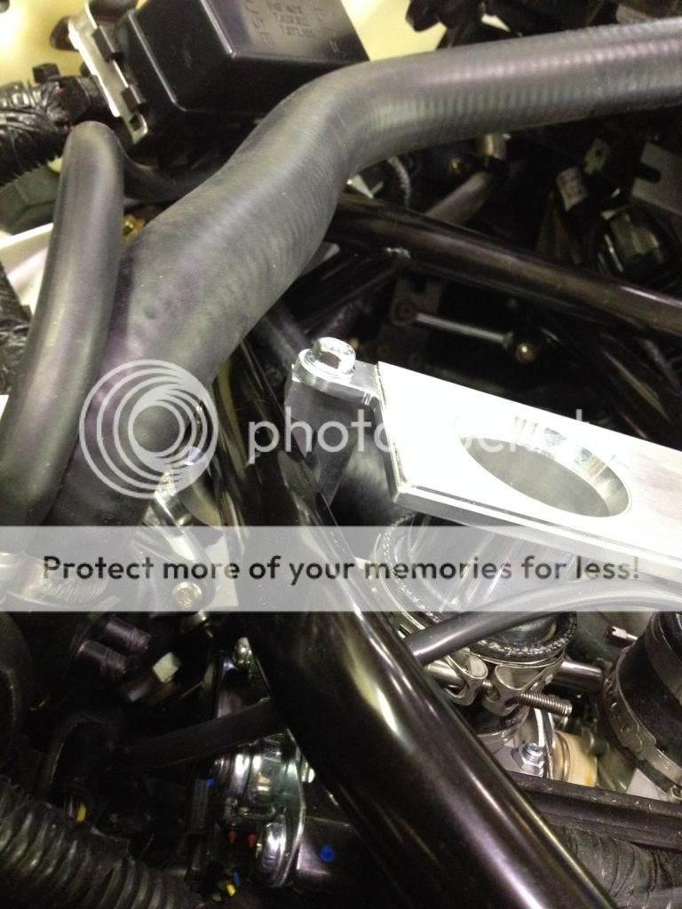

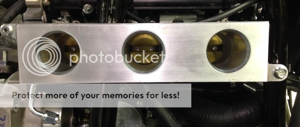

On the Nytro we were able to bolt our intercooler to the throttle bodies so that the intercooler wouldn't blow off under high boost or when you chopped the throttle fast. The steering post on the viper didn't allow us to do that so we made this billet hook that holds it down to the steering support post. We never had them blow off during testing but this adds some extra support for higher boost levels. This was harder then it looks, the post runs down and away from the intercooler creating a compound angle.
