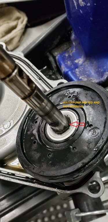

2017 LTX LE - out at the lake Sunday, did some easy miles to break in a new belt. Did a few pulls on the lake, and immediately after getting off the gas on my last pull the engine temps went through the roof. I let it cool down for 20 or so and then tried to get it back to the cabin but no luck; temps would climb north of 200 almost instantly.
Towed it back, and did the usual stuff to see if there was maybe some air trapped in the cooling system. I couldn't get any heat at the rear exchanger and decided there was a mechanical failure somewhere. First time the SW has shortened my weekend since new, so I'll cut it some slack!
Dropped it at my dealer yesterday and asked them to pull the water pump. Sure enough, the impeller had let go from the shaft. The shaft/impeller are supposed to turn as a unit, but I can spin the impeller freely while holding the shaft. Don't recall anyone else have this particular failure yet? You can see from the log below how quickly the temp climbed - about 15 seconds and it was over 240f.

I will chime in as my water pump did this on the first TY ride last month. The very same day, another member on this site called me with the very same issue.
When I ordered my replacement pump, the dealer I ordered it from said there have been a lot of water pumps ordered recently...so watch yours.
lakercr is correct, the temp will skyrocket without warning and with my sled, the temp went up to 250F and would not shut down the engine! This is a serious problem as when the cooling wasn't circulating, my temp light was not on at 225F!
Same thing tho as no circulation to the rear heat exchanger.

Were you cruising when it failed, or going pretty fast? You can see from the log that mine failed the moment I let off the throttle from a pull. Don’t know if that’s significant, or just a coincidence.
