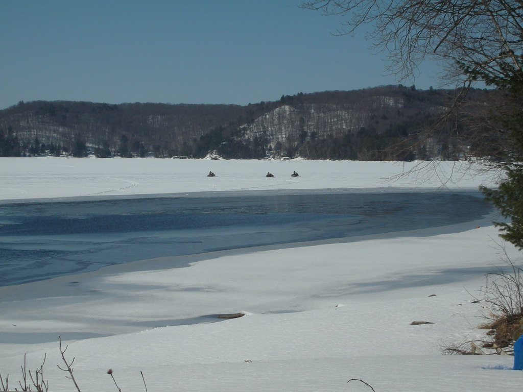

This picture was taken on Sunday, he wasn't running the full channel, but cutting across a corner of the open water.
