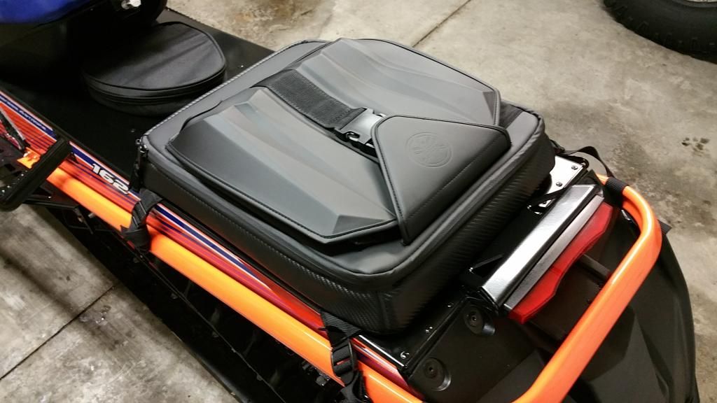

My xtx le has the mountain seat and im looking for a tunnel bag, all the nice bags I see come fitted for the trail style seats. I would like to see some pics of diff set ups.

I added the Ice Age Pro-Motion kit to the skid of mine recently. Haven't had a chance to test it out yet.
Side note: Ice Age wants you to drill out the rail for the lower shaft mounting bolt for a 10mm instead of 8mm stock. I didn't feel good about not being able to go back to stock, to gain .080" in bolt diameter. I made a replacement shaft with 8mm threads instead.
Yamaha tunnel bag out of the accessories catalog. Kinda disappointed it doesn't work better with my SOS shovel. Might have to buy the shovel it was designed around

Will this bag work with the mtx seat????Im pretty bummed that there is no under seat storage because thats where the gas tank is so the best i can come up with, with still looking good and having room for straps, water, and other gear is this. I also saw a tunnel rack in the "conquer snow part2" video on youtube that looked cool but i cant find it on the web yet. if anyone has a better tunnel storage idea let me know, not really looking for a gas rack

Not sure i changed my mind and went with a Mountain addiction bag instead.Will this bag work with the mtx seat????
