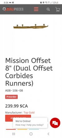

Are these called something else now? I was looking at the Qualipieces website, and don't see/can't find the model shown above. Just thinking in advance what I want to put on my '22s when they eventually/hopefully show upInteresting they should be good against darting too. Proof is when you try them but I' dont get how they or any other carbide can be better in loose snow as mostly is the keel of the ski doing the work? Carbide are for hard pack and ice no? Just trying to understand how all that snowtracker metal produding deep would be worst in loose snow.
Qualipieces offset

I believe these are them last year they were available in 4, 6, and 8 inchAre these called something else now? I was looking at the Qualipieces website, and don't see/can't find the model shown above. Just thinking in advance what I want to put on my '22s when they eventually/hopefully show up.

Thanks!I believe these are them last year they were available in 4, 6, and 8 inch
