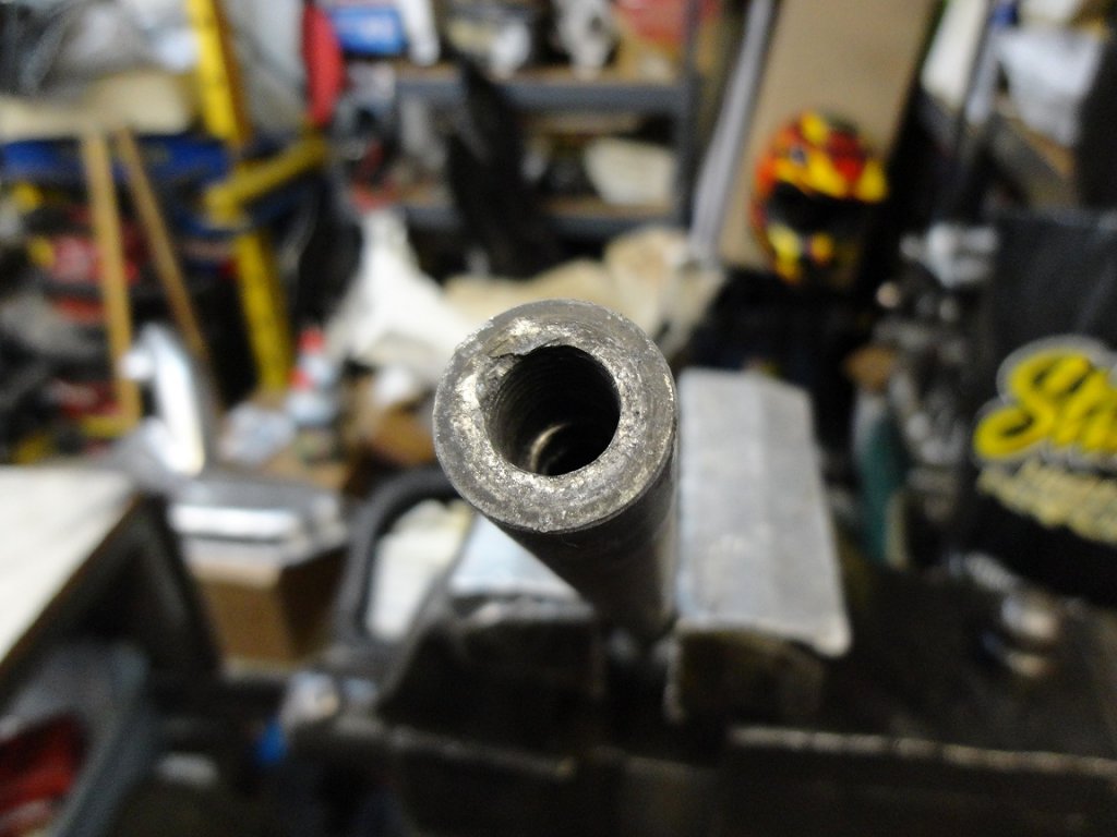

What broke?View attachment 124761 View attachment 124762 Great people of Muni that pulled out all the stops to help me fix my broken sled at 8pm on New Year's Eve! Munising Motorsports Sam and Cristine at Borders Inn(comfort) I cannot express how wonderful they are! THANK YOU! You two.
The shaft the front arm attaches to rails. I cant really explain it but both sides the bolts were out with right side bolt was still in rail and threads in shaft completely gone. I must have over torqued them is only thing I can think think of. Made a Hell of a noise and stopped on hill just as you go on 419. Lucky. The Center shock is a new Axis that I should have taken time to setup right but being first real ride on trails I kept riding. Second day I did set it up nice was working perfect and was not having to lift at all for anything. It broke on way to supper. Were going the long way! Usually it seems when I get suspension perfect I go faster and then find out what is next weak point. Anyway Muni dealer had shaft and bolts and we made up the little steel inserts that are in rail itself out of washers and a shock bushing. Worked perfectly!Will get some pics since the dealer said he had just sold a few sets of those little spacers in rail week before. I will add those to my bolt bin in my tunnel bag. Probably find a through bolt also instead of two separate bolts in aluminum threads. Also the arm in air must have knocked the wheel off. Never even found that! All three of us made some type of junk but was a fun ride and great memories. Next weekend for sure.What broke?
One end
Other end
