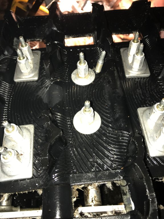

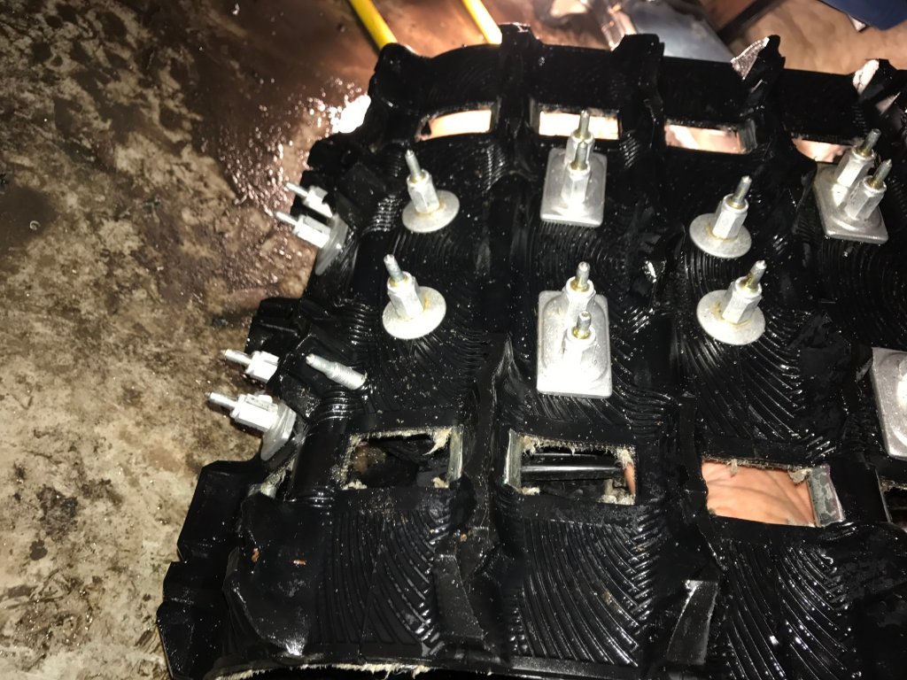

as the nylock doesn't get to enough threads and will loosen , and some of the studs came out and speared thru the track . I wouldn't believe it was possible to have a stud go thru the track in a spot where there was no hole drilled , if it didn't happen to me.lost about a dozen studs and had to switch to the medium nut .
I was lucky there wasn't more damage , as it only chewed up a bogie wheel a little .

Holy crap,i have never seen that one before,yes you are so lucky,and still have rear heat exchanger in one piece,with no holes,well that's a big Blessing.tall nuts are too tall even for the Stud boy 1.5"
