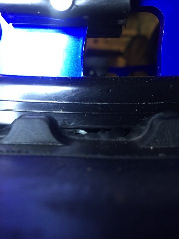

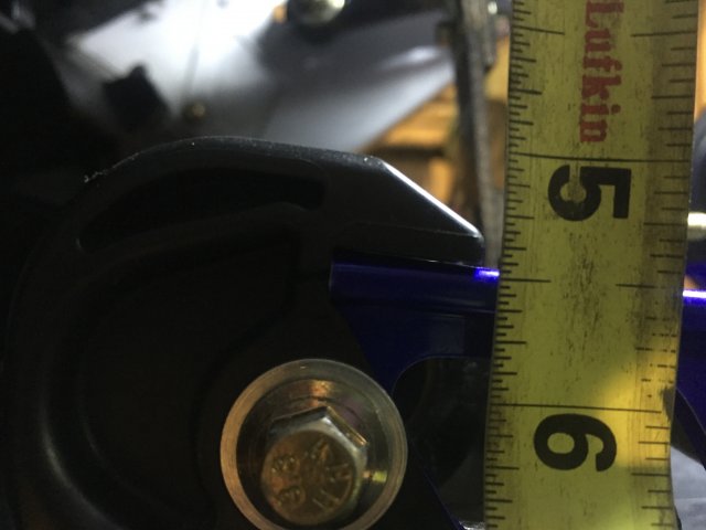

Found that the one rail seemed higher than the other today. Although the track walks over to the left and the left rail was the lower one. Weird...

Generally the track walks to the opposite side from the one that causes the track to be tighter at that point.

Yeah that's why when I saw this I got excited, but the left side would be the tighter side (lower rail) and its walking to the left. So this seems irrelevant.
Generally the track walks to the opposite side from the one that causes the track to be tighter at that point.[/Q

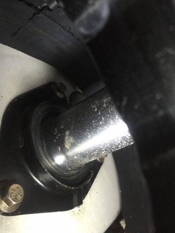

On the shaft where upper wheels are on is there still spacers at each wheel? Some had plastic and some had washers. Both have been known to fail. This can cause the upper wheels to be out of position.

Your taking the aluminum spacer between the drop bracket and idler? They look fine.

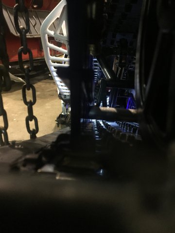

Rails seem straight.

The front arm might be tweaked somehow, or where it mounts (either end) is egged out. I don't know that skid real well, but looking again at all of these pictures it has to something like this. I would pull the skid and remove the shocks/springs. Then carefully move it through the travel to see if something is amiss. With the front arm laid flat (compressed) it is likely that one side hits the bumper well before the other side.

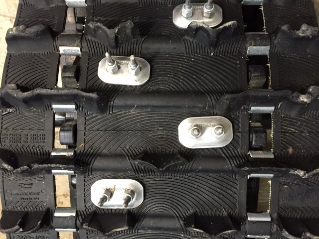

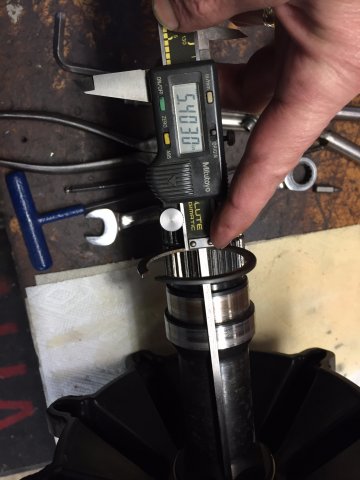

"shagman, post: 1253376, member: 21719"After more inspection there is a little wear on the inside of the brake side driver. Here are the measurements.
Chain case side.
Measured from the inner snap ring groove outside edge to edge of driver hub next to shaft with calipers.
New shaft was 5.16", Old shaft was 5.32". I got 5.403
Brake side.
Measured from snap ring groove outside edge to edge of driver hub next to shaft with calipers.
New shaft was 4.535", old shaft was 4.661". I got 4.757
The reason I took the measurements from these locations is that the snap rings center the shaft in the sled and my track was centered well up front from the factory.
After taking measurments and looking over the old shaft and the wear on the drivers I'm going to leave the new ones where they are as it will give more clearance where its worn. Just a note: The wear is very little from what i have seen on other sleds over the years. 5800 miles on sled.
Here is my 8000mi drivers and how I measured which I hope is same as Shagman did. These are obviously worn but have always been tight to middle of track. I will either move them or replace them. Any advice? Never owned a sled with Extroverts before.
Chain case side.
Brake side.
Any luck with yours Martens?Yeah that's a good idea. I will try that. It seems to run straight on the drivers on a stand, but once on the ground and driven around the track walks left.
