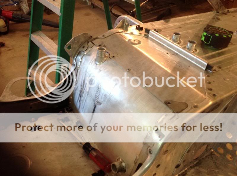

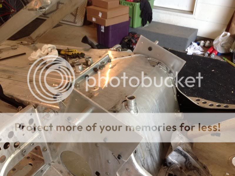

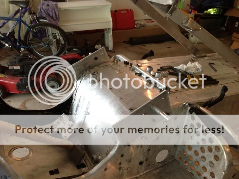

Did a little work today. First thing first found some common rivet/hole locations on boths sides of the sled to work off of. Then build some plates off the jackshaft cast support to give proper location for the jackshaft on either side. This will help me to bring the engine square to the jackshaft when I set it in to find the best spot for it. This is a bit different than I did it last time.
Can't wait to get the block later in the week and find out where it will sit in the chassis with the yamaha ctc for the clutches. Then it will be a matter of poster board, then aluminum sheet and then taking measurements off the aluminum sheets to machine the thick billet aluminum into lightweight strong billet braces that the engine and jackshaft will be attached to.

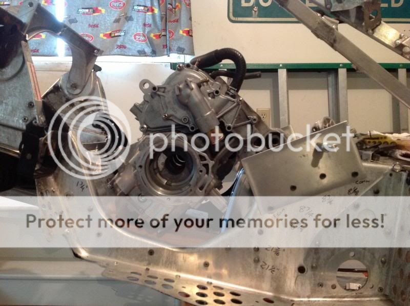

Ordered some 7075-t6 plate this morning. For a great price. $90sjipped for a .375x12"x48". That should easily make my side plates I was thinking 6 wide may do it originally. 7075 is almost twice the tensil strength of 6061.
Also slowly getting my engine and supercharger parts in the mail. Here is a little taste of the block sitting in the chassis. I am amazed at how much bigger the bulkhead area is. Someone said 2" I think it seems like more. I was super restrained in the rev and I have all sorts of room to work with in the rt. it is much needed. I need to find someone with a vector that I can measure some points on. I have to make sure that the vector engine is centered in the chassis as with the super it is just as important to get the clutch side right as well at the mag side.
Either way here is a pic.
