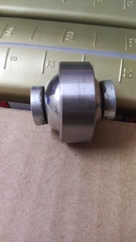

Just a follow up on these ball joints, these are actually the wrong ones as the 09 is one year only units. I didn't have my old ones at home when I put these in. The 09 ball joint ball has a raised collar on either side.
I will have to order from Yamaha.

Raised collar on the ball itself or on the casing? If it's the ball you could use washers .

On the ball, and I thought about washers but the hole is a different diameter also. What was Yamaha thinking?

I think on the 2010 there are hat shaped inserts on either side of the ball joint! I took one apart 3 weeks ago and it's still apart at my shop waiting for a-arms to come back from powder coating. You may be able to get the inserts and use your ball joints.

I can take some pics of the parts! I'm sure spindle dimentions are the same.

That would be great. Hellflyer.

Here ar
e some pics! Measures 27mm with bushings in the ball joints.

You can buy just the inserts from Yamaha. I should have a direct fitting replacement ball joint for 08-09 models in stock soon.

I did order the inserts so with the right washer combo all should be good. Thanks for the pics.

I don't think there are any washers! Only two are under head of bolt and under the lock nut.
