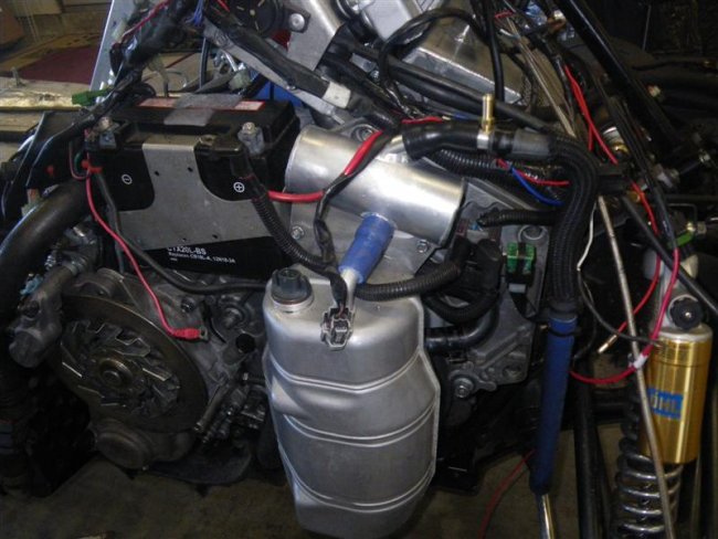

I was wandering about the roll over valve, don't see much talk about them and yes spendy and looks complicated, don't like the idea of the teather activating it. Very interested in your roll over tank set up.

Zx I'm not having any luck on the "roll over tank" anything you got on that would be a big help, also looking at the skid plates per your advise.
Barn of parts has some skid plates and so does mountain tech. Or you can make your own out of 3/16 aluminum. As for the roll over tank there is some info on snowest and snow and mud. I will get you a picture once I’m at my computer at work
not my sled but this is what it looks like the brass nipple on the top I did not do
Hey great, It looks like the tank just goes inline on what I think is the breather hose. I haven't really looked close at how the stock set up works yet so it will probably make more sense when I do.

Thanks for the pic on the roll over tank.
