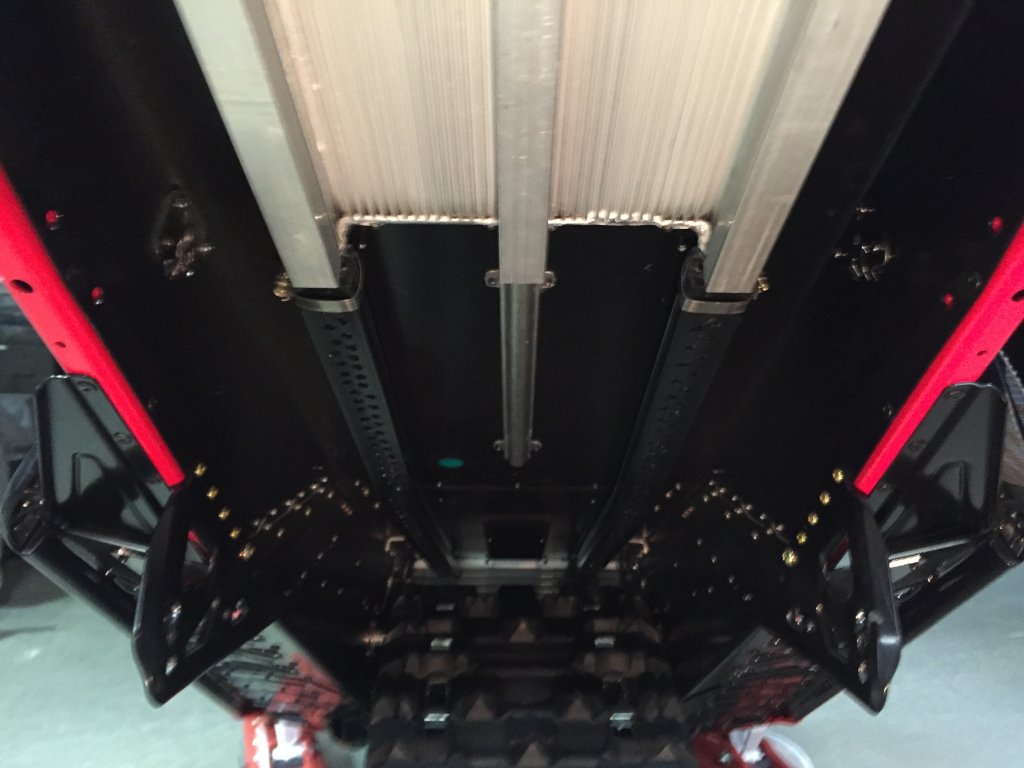

im going to put 144 down the center of my ltx. I got the tunnel protectors.
Just wondering if anyone is having any contact with the cooler. 1 thing I was not happy with was the rear cooler vs the viper.

Soo I just glued on my tunnel protectors. This stuff has some kick. Woooo.
I'm looking at where these protectors are. Have you guys made sure not to line a stud up dead center with the protector. I would think they would hit for sure.
Any insight?
You want to avoid the center of the track for sure. Some customers opting not to use the center protector but if we install we use and avoid the middle of track for studs.

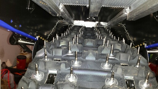

How many scratch lines? That is the pattern I have layed out and not worried about the center.View attachment 124695
I believe 32 scratch lines maybe not the optimal but durable. We avoid anything to close to the outside track edge.

its going to the yard to get much of a pattern with three per up the center. Without putting any dead center. I'm gonna start studing this afternoon.
