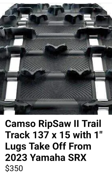

This is the ad. It appears to be a rip2 fully clipped.

It appears to me to be a 1.25 Ripsaw IIThis is the ad. It appears to be a rip2 fully clipped.
Definitely looks like a 1.25 RS2It appears to me to be a 1.25 Ripsaw II
Great price though!

Thanks guys! Could be a scam. As guy is claiming it's something else. Not to mention his inability to show more pics, etc.
