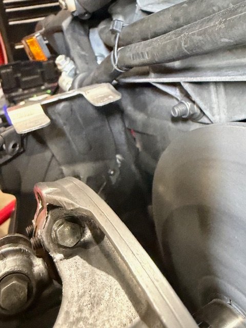

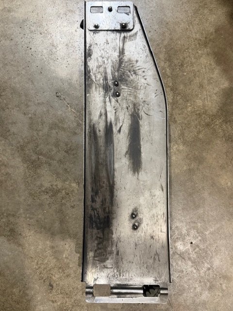

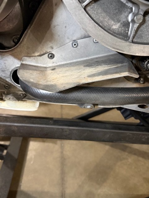

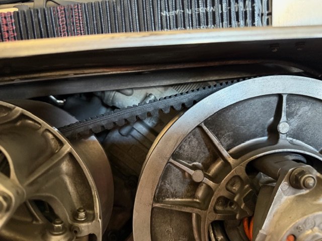

Well, checked the the underside of the belt guard and although there are belt markings, I believe that is just from the belt starting to delaminate and the pieces hitting it before breaking off. Nothing else shows signs of it coming into contact with the belt that would lead to the top of the belt delaminating:check on the bottom of the belt gaurd. for some reason the one on my 11 bent down and i was getting rub marks on it.

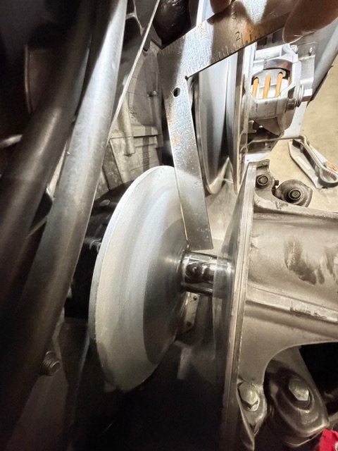

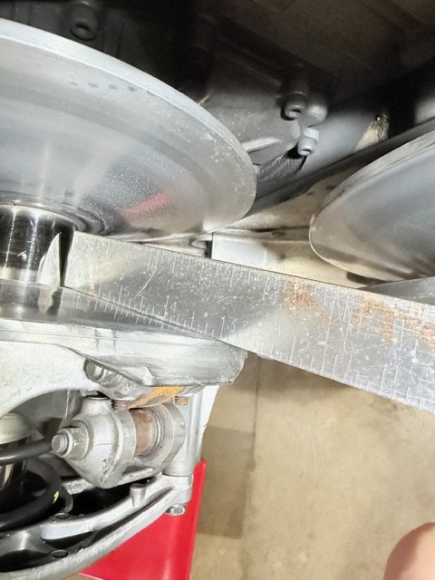

Put a straight edge on the primary sheaves to see how much wear there is about half way up. Don't worry about the grooving near the bottom, it has almost no effect.
The sheave surfaces need to be straight.
I had this same problem on a rs venture years ago and it was excessive wear half way up the sheaves, eating belts like crazy.
I tried my best to lay the flat edge against the front and back sheaves of the primary but there are some gaps, @74Nitro, is this what you were referring to or is this not excessive enough for it to cause my belt delamination issue:

Here's with the belt guard installed; nothing appears to be making contact with belt:

Yes, so what happens is as the belt travels up the sheave there will be a point where only the top portion of the belt is being pinched, and of course the top comes off then.Here's with the belt guard installed; nothing appears to be making contact with belt:

It's not a new issue. It was over 12 years ago when I came across this. It was an RS venture, started to eat belts, the top always came off first.X2 on this becoming an issue now all of sudden as I have a close to 24k on my 08 primary and it does not have this belt delamination issue and it too uses the 8DN belt. I know there were changes to the primary in relation to the set screws for the roller pins but did they also change material on their primaries where now the harder make-up of the 8DN is rearing its head?![]()
The owner was even on a trip in Michigan and came across a group of guys that worked for Yamaha and they had nothing to offer as to his problem. I went through everything related to clutching on that thing. Everything was in good order. Then somehow I got the idea to check the primary sheaves for wear.
Once the sheaves were changed.....problem solved!
