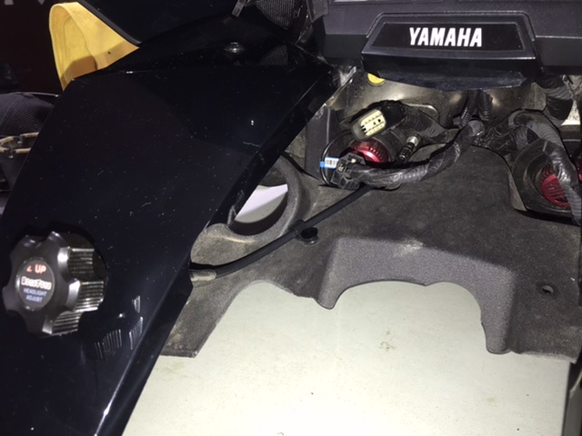

Installed a RoczToyz headlight adjuster and a mid height windshield.

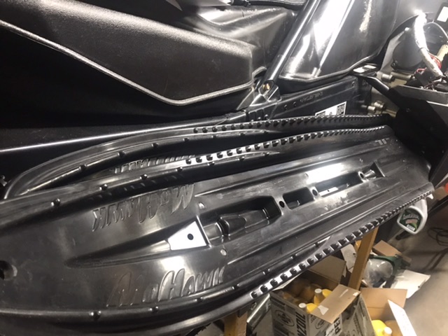

Same day my carbides showed up. Got my MoHawks mounted.
