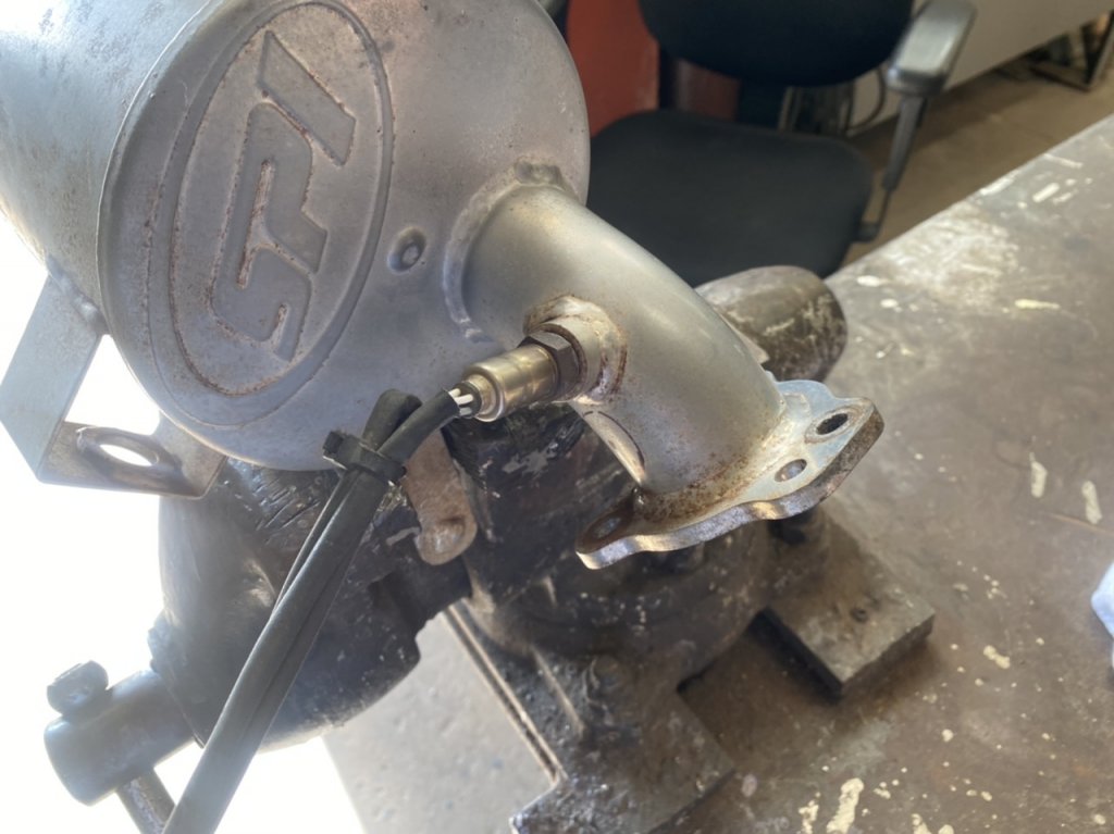

I had to get rid of this factory O2 sensor and bung. It’s too small for the Bosch sensors that I’m going to be running.

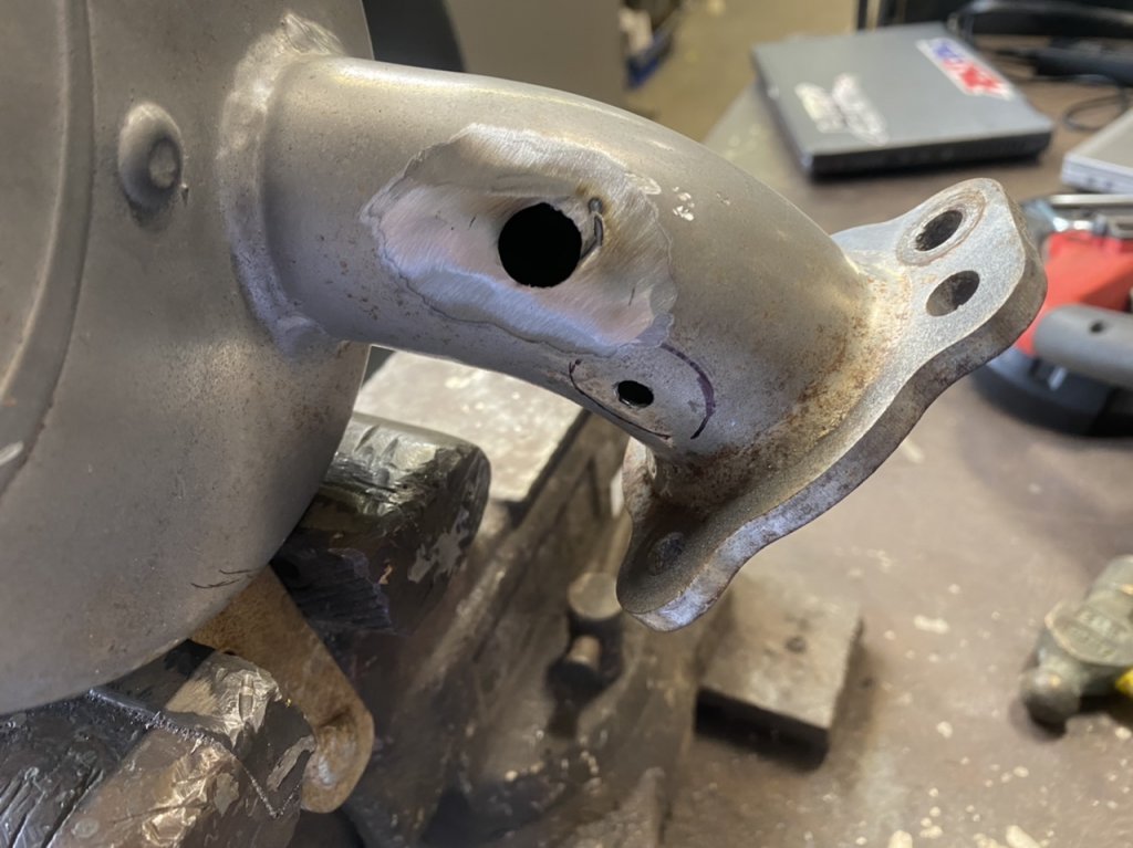

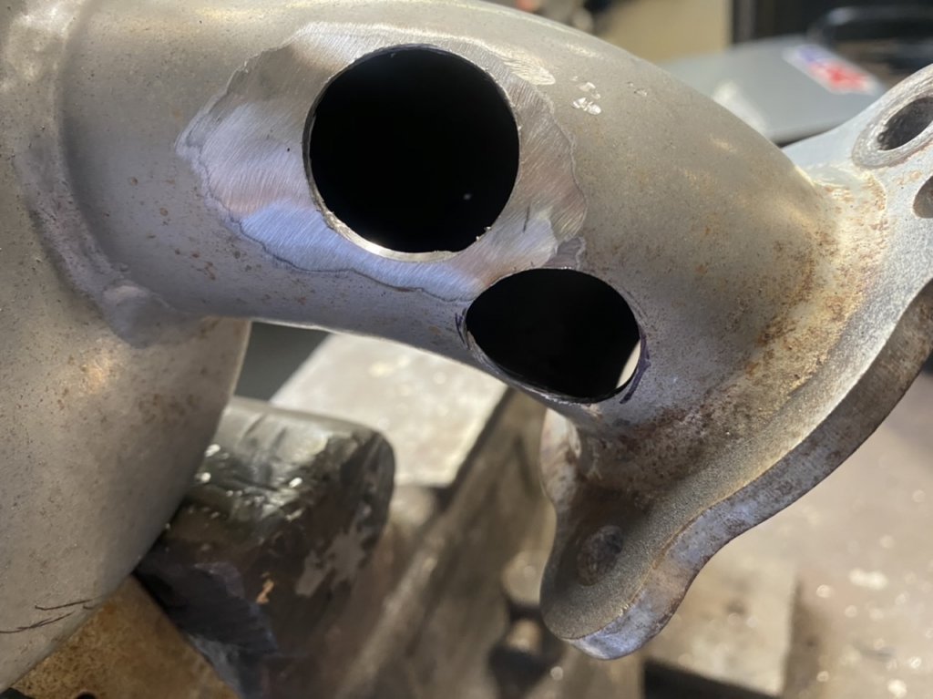

Cut it off, cleaned it up, marked position of second sensor and drilled pilot hole before drilling 7/8” with a step bit.
I got them tacked on but not fully welded so I’ll update when I get that done.

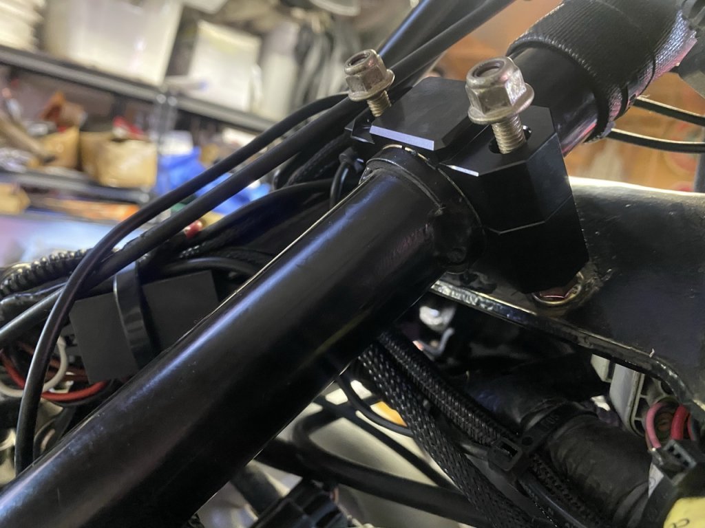

As far as the gauges go, I cut another piece of aluminum to mount the POD300 to and made it so it uses the bolts for the handlebar clamp. This should be ok for data logging and making quick changes.
The AFR gauge I didn’t want another connector on the hood so I just mounted it to my handguard support bracket. It’s out of the way and in clear view so this may be it’s temporary spot or I may just leave it. We’ll see how it goes.

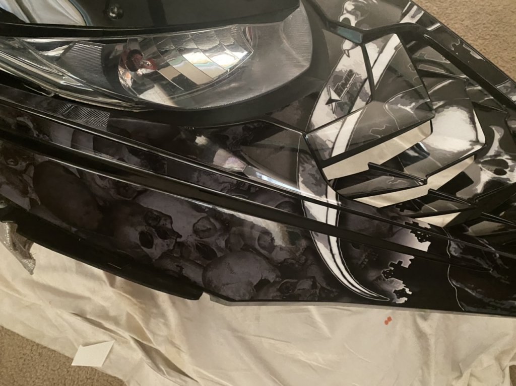

Now that I posted that picture I realize I forgot to mention that I put a new wrap on hood. I better show that too.

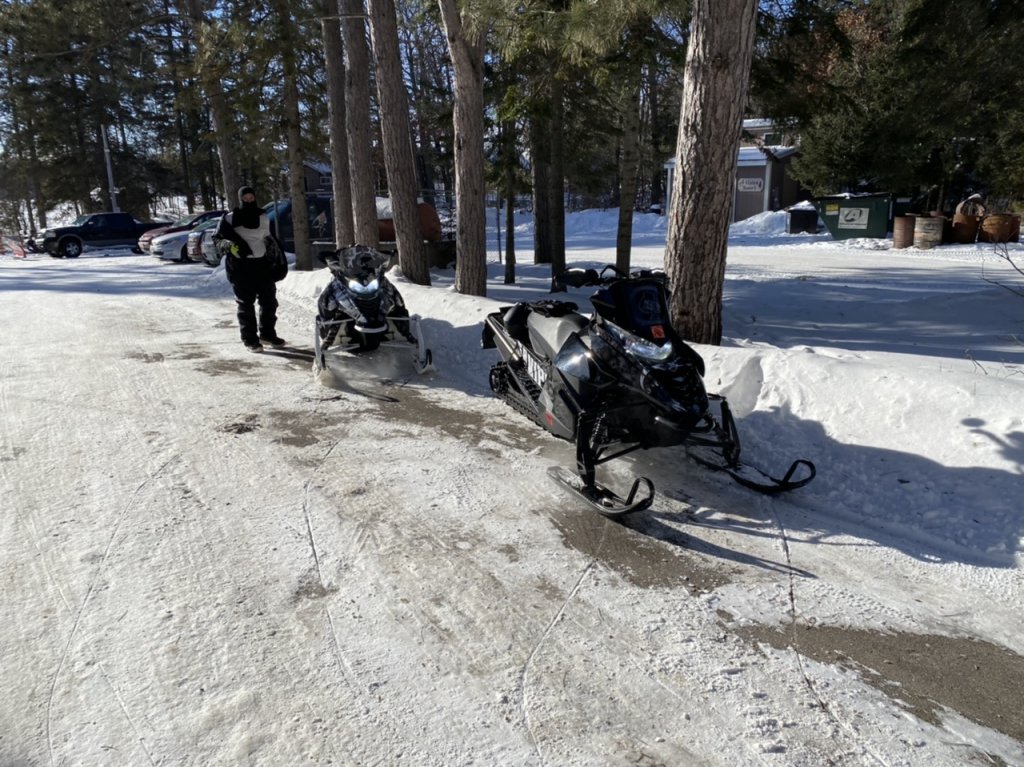

So back to the past weekend, we did our first shake down run on the lake and after my coolant leak was tightened, we hit the trail. We rode about 25 miles and stopped at what was Moran’s Landing on Swamp Lake. The owner Fuzzy was the president of the AWS snowmobile club but he sold the resort and now it’s called Karch’s Up North Resort. But they still had my swamp water! And they remodeled the place.
So now Fuzzy was gone, probably in Florida or something so we found out the new president is some Amy chick and she owns Boomba’s bar and grill. So we jump back on our sleds and head to Boomba’s. Amy wasn’t there, I guess she broke her leg from what we were told but the bartender was able to give us the renewal form so we could stay in the club.
From there we decided to loop west and then come back around and end up in Tomahawk to fuel up. The last 3-4 miles going into Tomahawk he’s going 30-35 mph and I’m thinking he’s data logging low rpm range or something. We get to the gas station and he tells me his oil light would flicker when he would get on it a little, that’s why he was taking it easy. After pulling his side cover we see oil down in the belly pan and it looks like his oil tank is leaking. I had to pee so bad my back teeth were floating but on my way back out of gas station I noticed they had Amsoil 0w40 so I grabbed 2 qts. He said no way he was going back by sled. It was about 1-1/2 ride back to the truck from where we were and he didn’t want to chance it. So away I went solo, it’s 3° and dark and it’s the first ride on my setup too but if I break down or crash I’m by myself in the woods not hanging out at Motel 8 in the warm with a 6 pack of Rolling Rock! But he would go get the truck and trailer for me.
I made it back to him in 1 hr 18 minutes!! I was flying.
