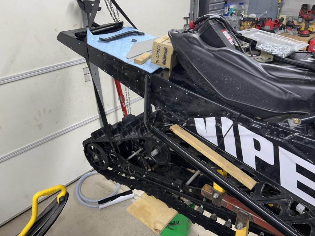

Before I mounted the PowderKeg, I decided it would be best to stiffen the tunnel and put a new rear bumper on it while at it. BDX finally released their XXX bumper so I ordered it.
Backed the sled into the shop to install the new bumper.
Dropped the rear of the skid and started drilling out rivets.
Hard to see the bumper on the black but it was actually nice. Fitment was good and install was easy.
I also removed the back half of the tunnel decal before putting the bumper on.

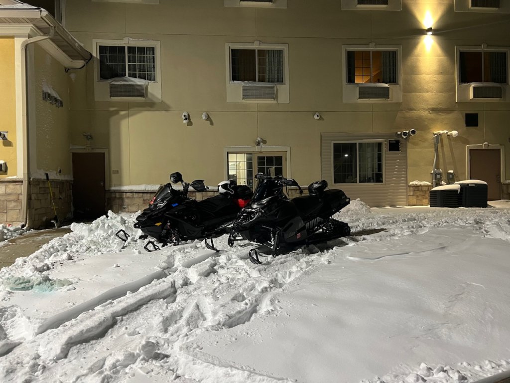

With the Winder still down getting some mods and maintenance, I took the Viper for the first run of the season. Strangely enough we had to ride southern Wisconsin, Johnson Creek to be specific.
Stayed at a hotel just outside of town near Polaris dealer.

End of season, doing my summer storage routine and I noticed the side of my tunnel is bulged out on both sides.
This stupid bumper/tunnel support did nothing to prevent bending. All it did was make me drill a thousand holes in tunnel for nothing!!

Before I went home for the week, I lifted the sled off the bumper to keep it hanging under stress while until I went back up north.
When I went back up I drilled out all the rivets and removed that POS bumper. I used a squeeze clamp and tried pulling the tunnel back into place. I actually got it decent but what to do about all these holes?
I said screw it and bought a new tunnel and even the support brackets that hold the rear skid.

Made it up north last weekend and replaced the tunnel. Only issue is I had aluminum rivets and all the rivets I drilled out were steel. So I used what I had but only put an enough in to hold it in place and ordered the factory rivets including the structural hardened rivets that go in the suspension bracket and into the bumper.
