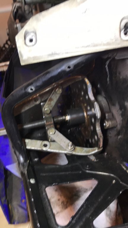

Alright. She’s all tore down.
some things that where no surprise
-axle ruined again, got it machined and sleeved this time for a better fit
- upper gear in chain case ruined
Found one of the hoses above the track to cooler was leaking. Cheap fix but lots of work.
I checked the valves today. They are all bang on. No adjustement needed

Did you have issues finding a machine shop to do the work to your drive shaft?
MS
MS
Joe ltx-le
- Mar 26, 2015
- 1,524
- 591
- 988
- Beaverbank-ns
- 2017 sidewinder ltx-dx
No, I’m lucky that way. Just need a good machinist, it’s not a real bad job.Did you have issues finding a machine shop to do the work to your drive shaft?
