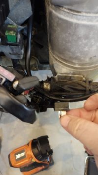

What is this? There's power at this point it's attached to the wire coming out the starter relay. Is this a possible blown fuse?

Hmmm, that's just out of focus enough for me to not recognize it. But look around and you might discover what's going on. You might be close.
