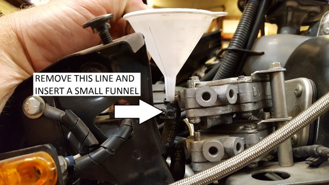

Mike, the carb sleds will lose prime from fuel evaporation after a few weeks of sitting, especially this time of year; I'm guessing this is one of your problems. Remove one fuel line from the fuel pumps, insert a small funnel. Pour fuel in the funnel and wait for it to go down. Keep doing this until it stops taking fuel; it will fill all three carbs, as they're all inter-connected at the float bowls. Some guys even clamp the gas tank vent shut and blow compressed air into the gas tank to prime. Fuel pumps are on the left side of the sled under the key switch panel and headlight pod.Going to try to get at it this weekend working all week
Your no crank problem is probably related to cranking and cranking from trying to start the sled with all the fuel evaporated out of the carbs. You could have either burned up the starter or blew a fuse; hopefully the later. It could be a ground block or the starter solenoid cable next to the battery as well. Your battery could be shot from the frequent starting and no charging too!
