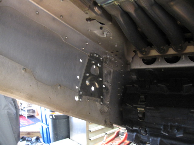

Here is another Apex XTX conversion that I did for ViperDave. We took a 2011 Venture GT 144 skid and installed it into the XTX. It was quite a job compared to the conversion on Nick1945s sled but all in all it turned out great. I had my 2009 Venture GT standing by as a template and it made everything much easier to have the mounting brackets. Dave thought since we named the other conversion the Apex XTY this is now call the Apex XTV for Venture skid.

Thanks to Tom for taking this task on. Was nowhere near simple to accomplish. 1st time raw instal and it took 7 hrs. to do. Nick, no, I won't be revalving the shocks for now. It's a2012 skid with new spec valving. Relatively low miles, so no need at this point. We did instal Excel wheels and Hygear torsion spacers. We also had to repair the left sid
e tunnel protector. 1 bracket was broken and another the rivets had pulled out. Thanks to Tom's buddy Ed, we got them tig welded and they're better than new. Looking forward to the1st ride!!!

Grimm, Several reasons for the switch. I've been riding a 144'd Attack for 4 seasons. Having straight vs tipped rails is a plus.Not enough trail traction with the tipped rails. The slides last a LOT longer in the Venture skid. The biggest reason is the ride. There seems to be a lot of stiction in the XTX skid. The Venture geometry seems to stroke progressively compared to the XTX. This is my trail sled so the ride will now match better for my needs. Anyone that has ridden a 2012 Venture knows what I mean. I'll certainly keep everyone up to date with how it works.
