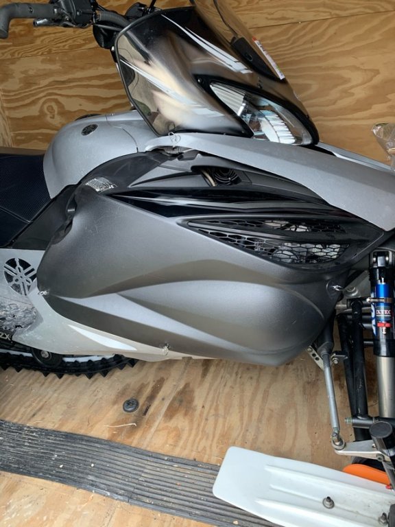

Anyone know what it takes to put 2011+ panels on a pre 2011 apex?
If you can hold on until tomorrow I can try and see. I know years ago someone on this site took a gen one chassis and turned it into a gen two. I think the biggest question would be the size of the throttle bodies and air box with air horns
Fairly sure you will need the side panels, hood , airbox lid, headlight cover and windshield
- 21,653
- 9,271
They will go right on no problem. Its best to change the hood and air box lid tho if you really want it to look right.

Thanks guys, I like the look up the 2011 panels, I will need a custom hood anyway. I will buy a set of 2011+ then!

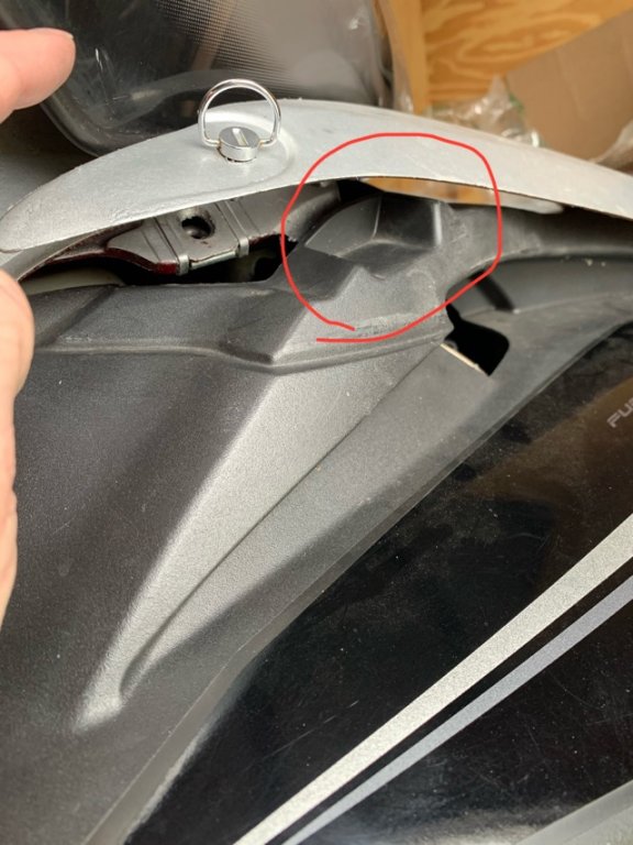

They do fit with a slight interference on the stock hook, it will work fine for me. Thanks all!
Update with pics once installed.
- 7,844
- 2,039
that hooks under the tab behind it in the pic with the circle. my 11 and 16 hood will not fit unless it is under that tab.

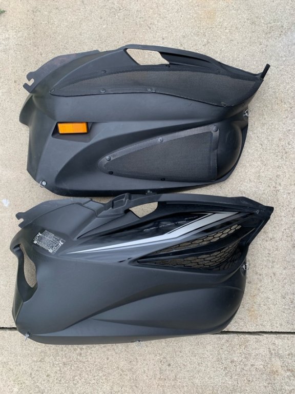

This is a stock 06 hood. I know its not a bolt on but close! Just a fyi for folks. Im going with a aftermarket hood anyway.
