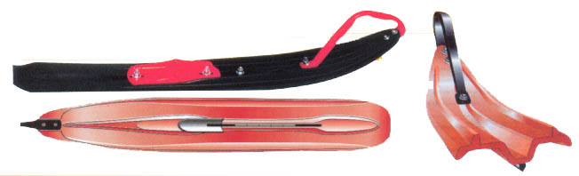

I have a 2012 with a ice-ripper track and I'm ready to replace the stock carbides. It does dart, sometimes bad enough to make me uncomfortable. My question is would I be better off with 6 inch duallies or 8 inch singles.
Thanks
Mike
Snow trackers period had them on my last vector...Then jack up the front of your sled and take off all the tension on your two front springs ,and then put a little tension on the springs and then go one turn and it will rail around the corners and no ski lift.

WE NEED SNOW !!!!! LOL . From reading about the Snowtrackers the Semi Aggressive aren't so critical on getting the ski's perfectly straight. Now if you go Aggressive one's then yes. I think Snow trackers are the simplest bet for a good ride ! and the steering becomes much lighter ! which is a big benefit for twisty trails and long rides. I have tried many different ski's and carbides. If you want cheap? look up the Half pipe mod and just go with that with your regular carbides.
you can make them very cheap and they work!!
DGZRT
- Feb 23, 2006
- 1,181
- 486
- Stevens Point Wisconsin
Another pic.
Cut a 1.5"dia. pipe in half after marking where the bolts for carbides are . Round up both ends and install on Keel like shown. They last for many miles and improve darting very cheaply.

I also have a 2012 Vector. If you have the original single keel skis go with snowtrackers. I ended up with Curves and slim jim duallies and they are great.I have a 2012 with a ice-ripper track and I'm ready to replace the stock carbides. It does dart, sometimes bad enough to make me uncomfortable. My question is would I be better off with 6 inch duallies or 8 inch singles.
Thanks
Mike
M
member 24641
There are tons of opinions... however I think we can all agree on some straight facts.
1. Alignment is the number one priority. It is relatively easy to do an alignment and get spot on toe in/out. All you need is a measuring tape and some rope.
Personal example: my SRX was darting and tracking badly a few years back. Did a quick alignment and it is still perfect.
2. Dual carbides/snowtrackers are night and day compared to the stock single.
Personal example: My vector was borderline dangerous with darting/ski lift. Put a pair of dual carbides and it's like a sports car. No darting at all, easy steering, no noticeable pushing.
