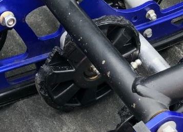

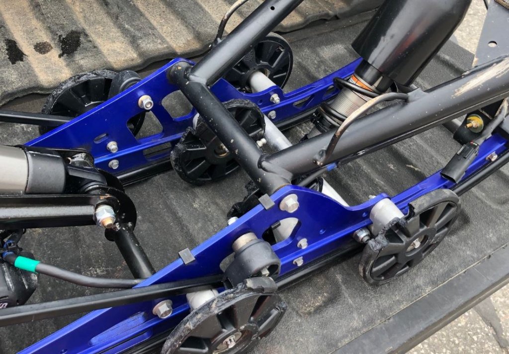

Did anyone with a 2019 winder have any issues with their idlers breaking? All 6 of mine are TOAST!! Not worn out... actually broken right off!!
5000km season. I talked to my dealer who put in a warranty request. Yamaha said "he has studs, we will not cover that". All my studs are torqued and checked frequently. Definitely not studs. Also, what's their excuse for the outside of the skid?? I dont have studs there! The '19 wheels are definitely not as beefy as previous years. They have little contact with the outside rubber.
Not sure what to do here. They are relatively cheap to replace, however I don't want to have to go through this every season. I am considering putting a full set of 2018 wheels on which are a much more robust design.
2 questions...
1. Why did this happen?
2. Replace with 18 or 19 wheels?
side note... rear axle wheels are not looking that great either. Only the top skid wheels are still in good shape. Likely because they are solid.

We just came out with the super duty idles with the larger bearings. Will be a one time purchase!!
$40 ea.
JT Products
8105450066
thanks! Will the work on the inside of the skid?
Yes, all but the rears and the top two.thanks! Will the work on the inside of the skid?

Well I seem to only get 1 season out of the center two wheels. They are chewed again likely from stud heads . How do you figure your wheels will handle that abuse? Thanks Todd
