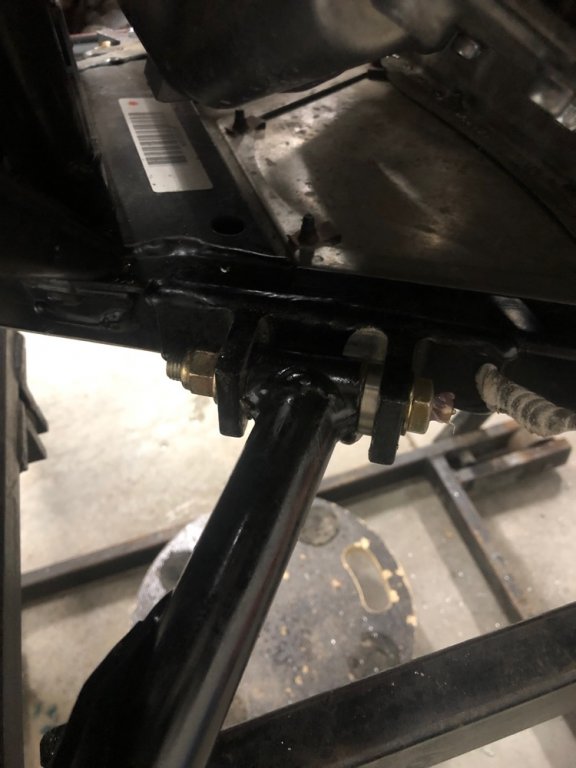

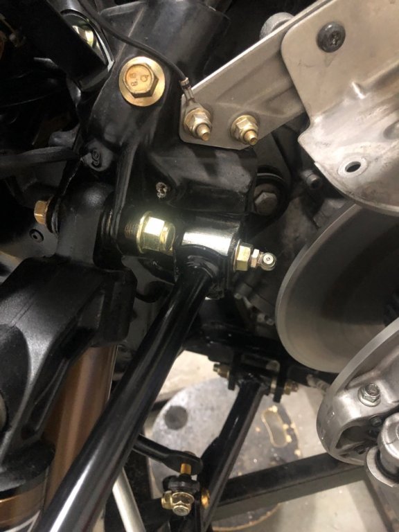

Also put grease able bushings in front end really nice pieces I’m not advising for him just showing what I did.

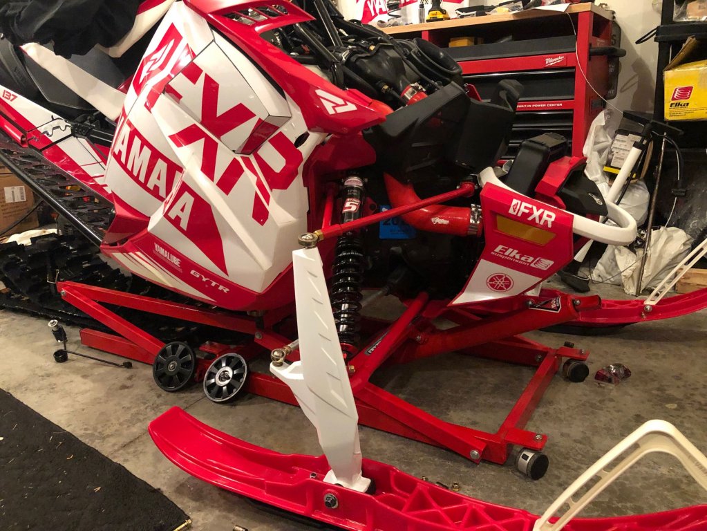

Nice! So did you buy the new rails also?
I got the new 2020 parts for the front end and put them on. It was good timing as I had my shocks already off to be rebuilt.
Looking forward to see what type of improvement this may make as already liked the front end.
View attachment 148932 View attachment 148933
Also you did an awesome job on your sled I love the red looks sick. You did change rails also and I noticed yours is a 137 does cat make 129 with this front end I never really looked into but will check out see idle 2 stroke has it on there.

Can those bolts be bought like that or did you machine them?View attachment 151264View attachment 151265 View attachment 151266 View attachment 151267

No I purchased them it’s a kit you buy. Mainway Solutions’s buddy does a lot of BRP stuff and some cat.go online and he’s located in Stoney Creek Ontario.Can those bolts be bought like that or did you machine them?

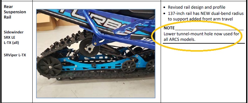

Interesting. Typically the lower rear skid mounts are used for off trail machines, so the snow will clear the tunnel.I have the Bulletin will get it up here later but was looking through 2020 Tech Update book. Here it is.

Out of stock currently damn it.No I purchased them it’s a kit you buy. Mainway Solutions’s buddy does a lot of BRP stuff and some cat.go online and he’s located in Stoney Creek Ontario.
