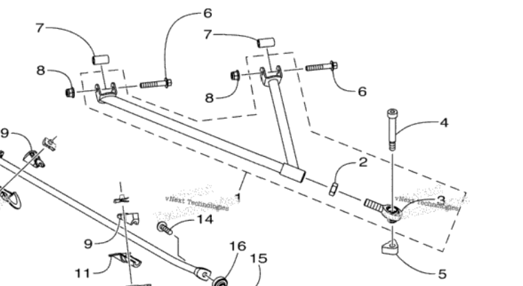

2020 LTX part numbers are on the fiche now. You can order black LTX GT Spindles
1
Knuckle, Steering 2. 8NN-F3521-10-00 $141.83
2
Knuckle, Steering 1 8NN-F3511-10-00 $141.83
and red upper arms now.
1
Arm, Front Upper Lh 8NN-F354A-10-00. $72.71 need 2? universal left and right I guess
1
2
1
@putz21 Were the U-joints on the Cat arms you ordered? (sorry if asked before)
You also have to get parts 4, 5, 6, 7, 8 listed in this pic.
