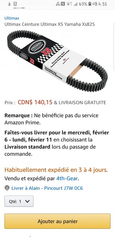

Thanks for the reply ! I ordered it ...

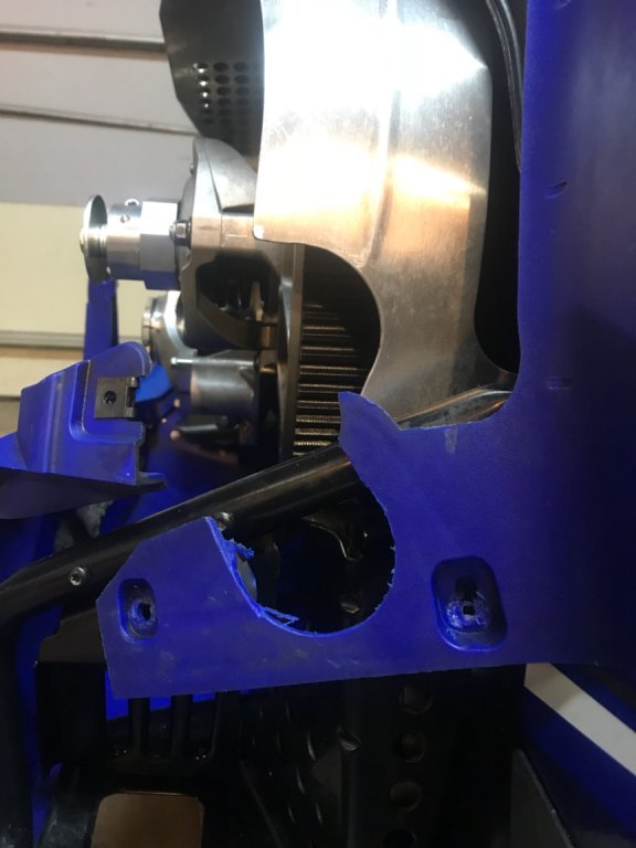

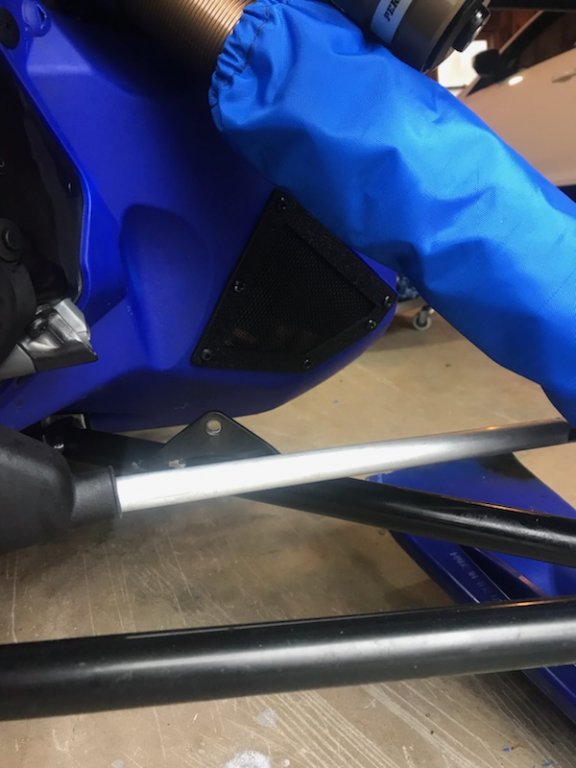

What kind of vents are you running
I used the Mo-Flow in front because they match the shape of the plastic & come with the sno-proof material. I bought different size plain vents for the back at about $1 a piece on Amazon.
I even cut a notch out of the rear of my clutch & put a vent right behind it.
