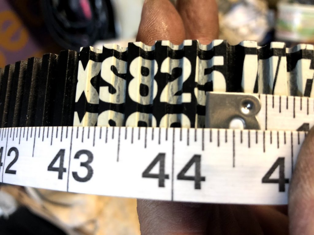

Circumference: notice the XS is quarter inch longer then the carbon
8JP=44 1/4''
Carbon=44 1/8''
XS=44 3/8''

Some of my measurements Steve... My XS is shorter then 44-3/8'' you showed by alot.
FWIW, I wont run anything but a XS now @ 97$ all in.
Dan

Very possible Dan, but there was 2 of us measuring exactly each belt the best we could & the XS was 1/4'' longer then the Carbon no matter what we measured with or how we did it. It was also thinner.

The numbers i measured are actually the manufacturers' spec numbers also
8JP=44 1/4''
Carbon=44 1/8''
XS=44 3/8''

My bud got 2000 miles on his first belt, but only 500 to 600 on next 2. This shows that something is moving after a belt EXPLOSION like the stub shaft as others have noted most recently BEERMAN.
I was very surprised. Holding in my hand, i was convinced the XS was my new "girl". It's beautiful.
