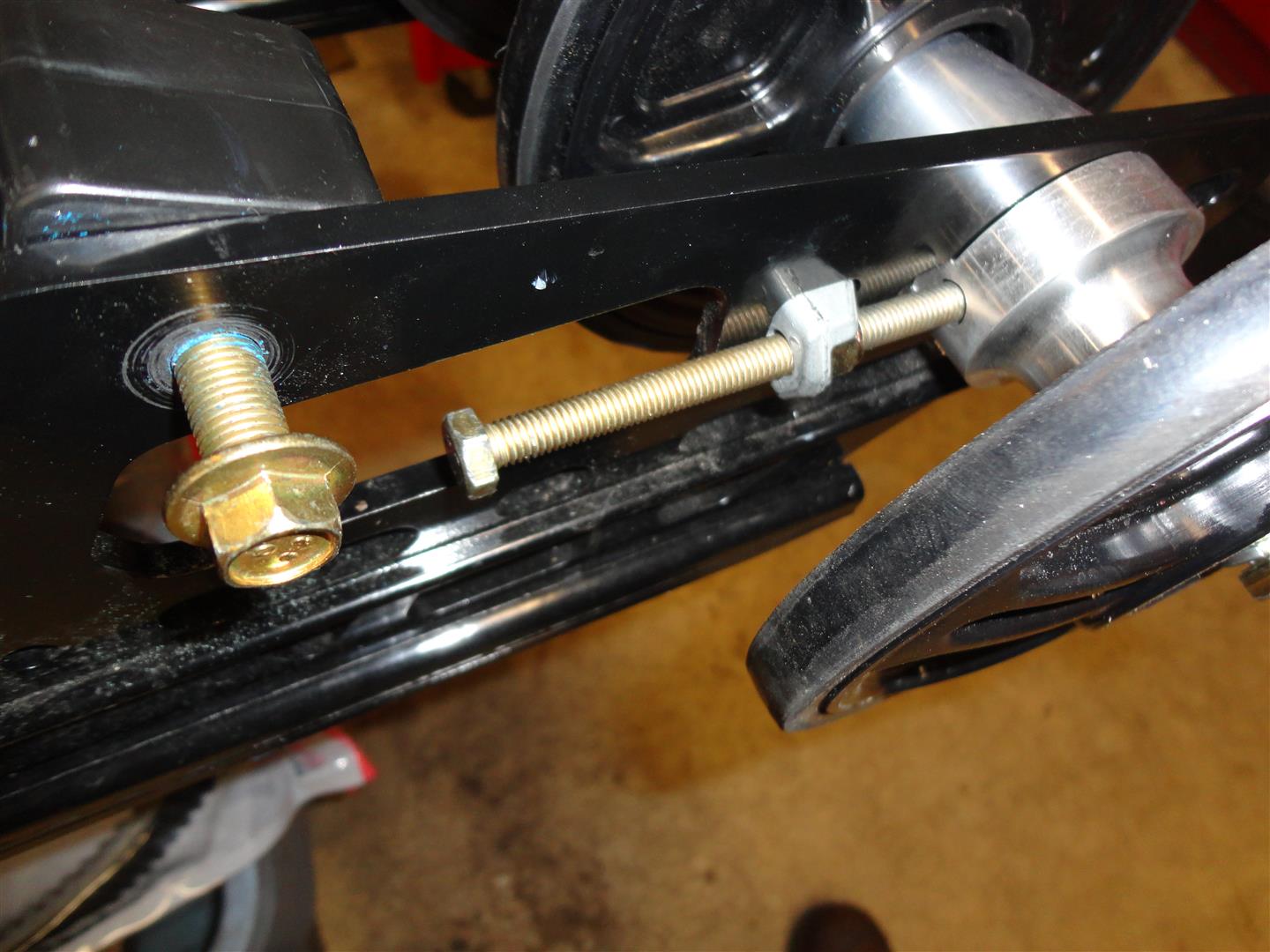

Is ulmers a solid axle?
What do you mean by solid axle ?
None of them will go though the rail because the slot where the axle would go though is to small so you will have a solid axle in the mid and spacers and two wheels then on the outside you will have spacers longer bolts and two wheels , so any kit out there that replaces the tri-hub is a great kit .
The one I got is a solid axle which goes all the way through the slot. Check it out in previous posts and here installed.

Very nice I must say !
I'm looking at Belanger racing ones to , it looks like he has the track adjuster coming in the other way ( from the back ) that one looks very nice too !
