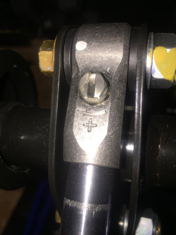

How are you adjusting "Rear Rebound: 8 from full soft" I cannot find an adjustment on rear shock?

It's up on the top of the chrome shock shaft near where the shock mounts to the rear arm in the tunnel. Look for a slotted screw up near the track and you'll see it unless your skid is full of snow.
