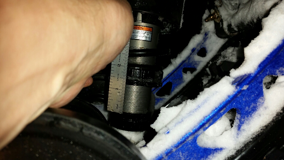

That front rear shock you show threads from the bottom of shock,that does not look like my skid front shock on my LE mine adjusts from the top,at the dule small spring.View attachment 135768
Excellent write up! You are a nascar crew chief, right? LOL
I actually love fooling with the handling, since all the power in the world on trails in our area, won't buy much. This sled has the ability to finesse through tight woods, and then open a hyper drive window as the trees stop!
In any case, I was not happy at all with mine, until I went to limiter hole 4, front springs 2 turns tight from full loose, rear springs on 2, and center spring tightened up maybe 1/2 way (didn't count the threads).
This changed the sled from tippy. unpredictable inside ski lift, yet not able to pick the front much (the transfer complaints) to a real blast, especially in turns. The front steers even easier ( not expected as tightening limiters typically makes steering harder) and I can accelerate through them with some nice oversteer...but I did lose some hookup, so I won't be racing anyone from a start. I don't anway. Somebody is always faster today, as it's a game of cubic dollars! I too am around 200, with curves and slim jims. The fourth hole does seem extreme too, but it works.
I did not move the transfer blocks as the ride gets compromised as soon as a suspension couples. On a flat floor, I lost maybe 1 lug under the front idlers with the strap up, but when sitting on it, it will compress, and then it start to lift the front a arms (slightly), which is why it is staying flat. It also had the effect of less sag, pulling on the front shock spring. The ride is still very good. I might try a few other combinatuons, but this is great right now. 2018 SE with the typical shocks...rebound up front is in the middle. The limiter and front arm are key to how the sled pivots. I think with the longer strap, the sled was pivoting too much from acceleration, braking, and sometimes the ski digs in, sometimes it pushes, where now, I can and be 'sloppy' with the throttle and just ride it..LOTS faster through our 1 mile test course...and confidence inspiring. Even if I get a ski up, I can hang it there and stay on the gas!!
Tried to use similar logic on my well set up monoshock apex, but shorter limiters makes ski lift...mainly because the extra weight up front not transferring makes the outer ski bite harder. The apex transfers hard and pulls the front in deeper snow, while the sw pretty much stays flat. Interesting!
Also should add, this was testing under the same conditions, from 10 below zero to 32 above, and the warmer it got the better it handled. Which is important for central ny....can't count on temps. being consistent, and the snow changes a lot.
(2 inches as shown works best with hole 4, rear springs on 2, couplers on 1, front springs 2 turns from loose. Tried hole 3 again with less tension (harder steering,.more ski lift) more tension (easier steering, but more lift) and went back to 4 with 2 inches showing. Really works well there, and able to put the sled wherever I want with easy steering. Leaving it alone now..lol.

I have an SE, so it's just a regular shock, but does the job. So that amount of tension might not mean much on yours. I spent 150 miles on a 1 mile loop, 1 lap and it wod suck..lol...in the garage, another adjustment under the same conditions, and when I finally hit the combo, I made 5 laps smiling to make sure I wasn't dreaming! I'm done adjusting. My son rode it back Thursday night as we had awesome snow, now melting....he had the fuel light on the apex, and I can stretch it out....he now loves the sw too, so it's not just me.That front rear shock you show threads from the bottom of shock,that does not look like my skid front shock on my LE mine adjusts from the top,at the dule small spring.
