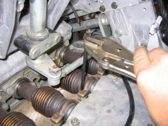

- When they were taking off the flex pipes, the shop broke a bolt off in the engine - they’re saying the basically need to remove the engine to get access to getting it out.

You don't need to remove the engine to get to any of the 8 exhaust bolts, they are just selling you extra labor. This is an easy repair.

Right angle die grinder and a end mill will drill out the broken bolt. I think they should be responsible for breaking the bolt, I guess it's there shop and can do what they want. I would not charge for it in my shop. Its an easy repair, I have done alot of them.
blown apex
10 min if its apart
weld nut over stud and let it cool then back it out
automotive shops do this on manifolds all the time
no drills needed
broke loosening i would charge
broke tightening no charge
no drills needed

You'd be lucky to get 3k. If you dont want to fix it, part it out. 1500 to 2000 just for the motor. I'm in ny and 06 -08 apexes are going for 1500 to 2500 max. I've done all that stuff you mentioned myself. You can get all the procedures her on this site. Call it a season and fix it over the summer. Mine has 15,114 miles. This year, I replaced both running board heat exchangers, stator, and I just broke the driveshaft last weekend. All fixed and running great at the moment.
