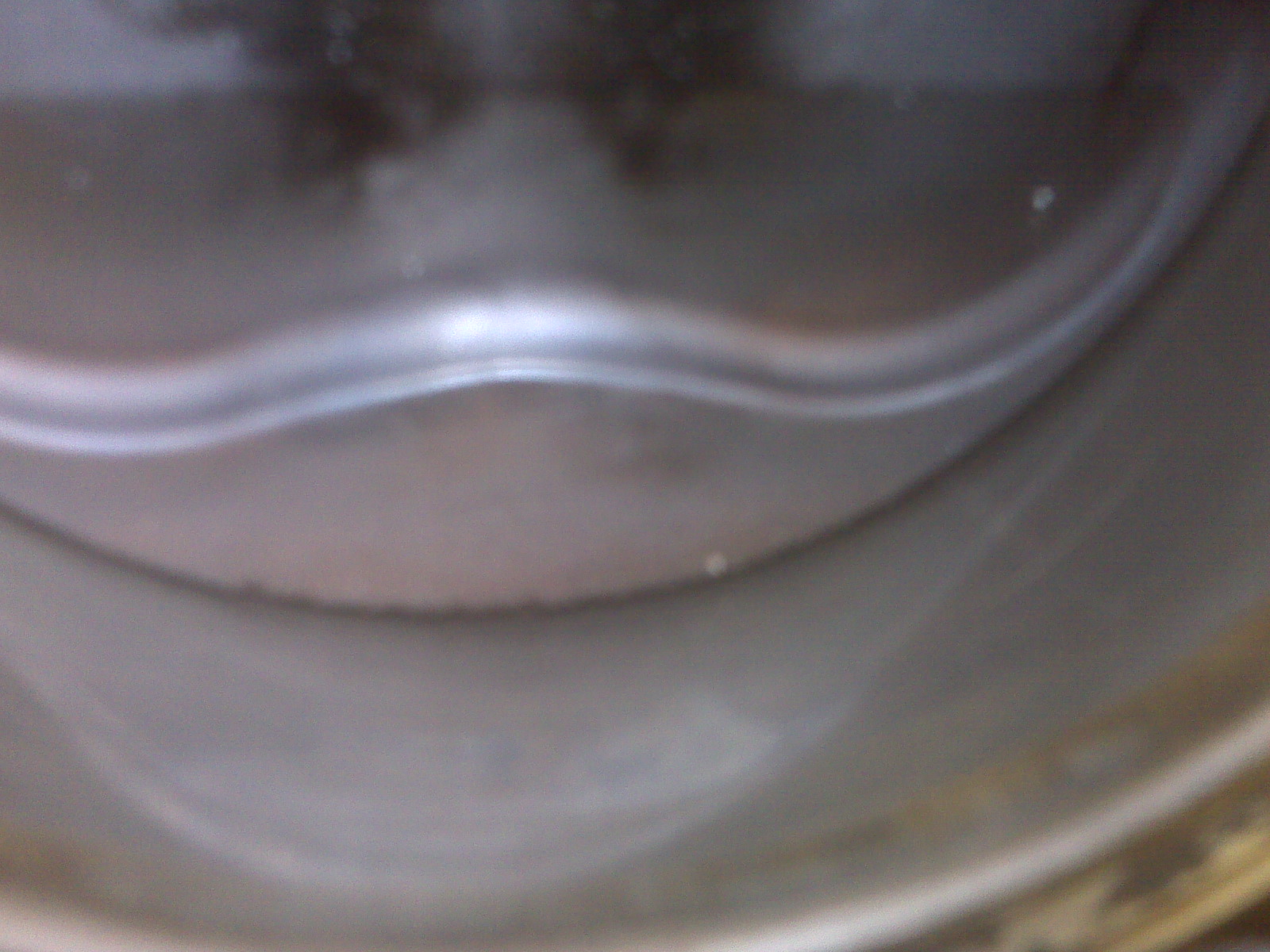

Most of us are getting boost numbers off the TB. There are now 5 Nytro's down in central Ontario. I think with most of us it is gradually breakdown, with most guys having between 1000-1500kms before its real bad. Every Nytro owner running the GEMS setup has got to be extremely careful, you can not run your midrange at 14 - 16 AFM. See attached pics, this is suppose to have been perfect tuning!!!

UPDATE , HEATH AT MPI JUST CALLED.
The Gems program WAS , set to come on at .5 lbs , major increase at 2 lbs ,
then ramp up fuel gradually to 11 lbs then flatline full fuel.
As of yesterday , NOW , set to come on at .5lbs , but ramp up fuel on a steeper curve to 6 lbs , then flat line wide open fuel.
Making more fuel available earlier !!
My sled shows 2 green lites until 2lbs boost (a/f 15-16+)
Then at 2 lbs , click goes to 3 reds , and a/f 10.5
and will be 11.5 + wot.
Running now Gems @ 1000 ft altitude

xtxnytro said:They told me to go off TB, because its a more accurate reading on what the engine is seeing for boost.
For your boost reading not your gems controller. THe Gems line NEEEDS to be in the intercooler.
The hard thing to grasp is there is so many kits that have been out in that area for 2 years now.. Few customers have almost 5,000 miles on them.
We have modified a tune to transition blue green mode sooner it has always been set to start adding fuel at .5 lbs.
Glen will have this tune for testing ina few days.

Yes the GEMS is Tee'd in the line between the intercooler and the fuel regulator, the boost reading that is being quoted is read off the throttle bodies for a more accurate number on what is entering the engine.

I do not agree with your assertion that the GEMS does nothing until 2 pounds. I have in fact seen real world results that disprove your claim. You can call whomever you chose at Dobeck I have seen it with my own eyes and controlled the settings with my own fingers. Maybe YOURS is not supplying fuel until 2 pounds due to a plumbing issue, malfunctioning GEMS, some other malfunction, or any of dozens of possible causes.
IF you were riding with a reading of 16:1 AFR and continued to do so for any significant amount of time then you should not have. That is a recipe for disaster and regardless of the underlying cause continuing to operate at that AFR is begging for trouble.
