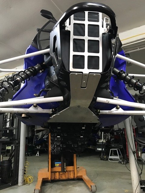

The heat sink concept was part of my reasoning behind the intercooler guard. By doing away with the nose cone it exposes the ends of the intercooler to fresh air and snow dust.
Plain aluminum pipes will get rid of the heat better the downfall is more connections. Those of you that want to polish and powder coat them you are going to retain more heat from my ecperience. I believe that’s way the brushed look. Looks better than plain aluminum with a uniform look. For those that have clamp issues look at a Breeze Constant Torque clamp I have them in.

Do you have any pics of that setup with the sled on the ground with all the body panels on?The heat sink concept was part of my reasoning behind the intercooler guard. By doing away with the nose cone it exposes the ends of the intercooler to fresh air and snow dust.
There should be pics in this thread.
https://ty4stroke.com/threads/snow-free-intercooler-guard.148989/page-4
