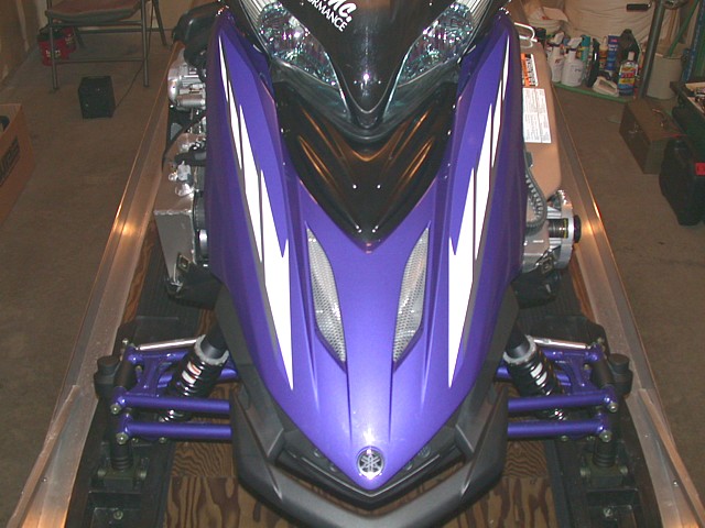

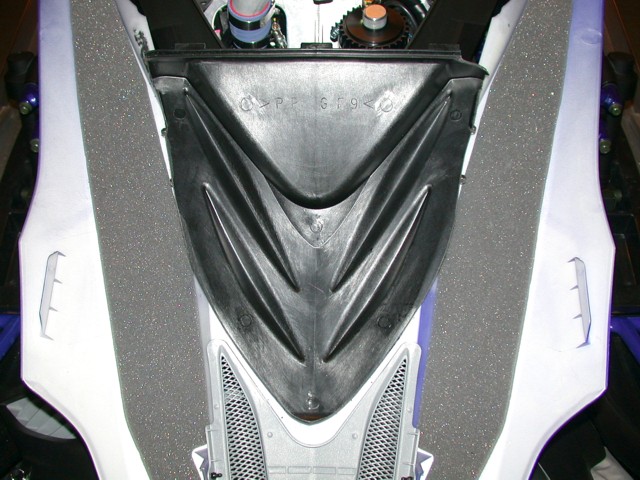

MPI doesn't give you anything to cover the box I just used a thick piece of pourus foam over the IC. 99% of people that looked at it couldn't tell it was modded.
One before with without foam this one is with.

On my sled I modded the air box lid and apoxied it to the hood. Everything is hidden then.
I was going to do that to but figured I would get maximum airflow though the cooler with the foam. Been in snow over the handle bars with no probs. Hey Bossman you got any pics of your setup? I went with the foam so that if we were at a radar run or something I could pull it out for even more flow. I sometimes even chill the cooler between runs to keep it cooler.

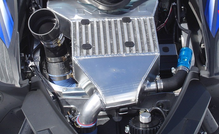

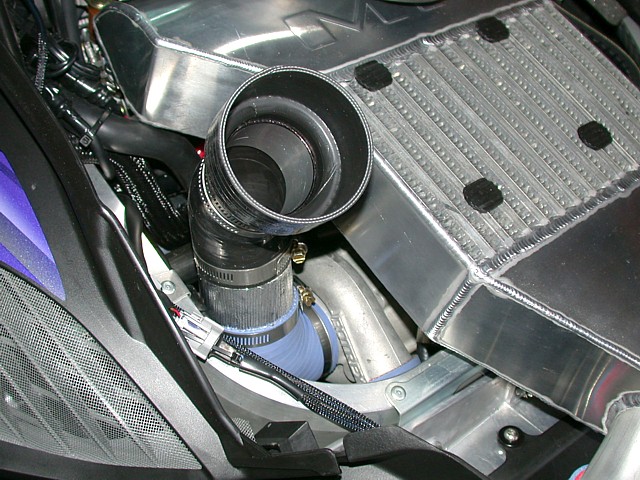

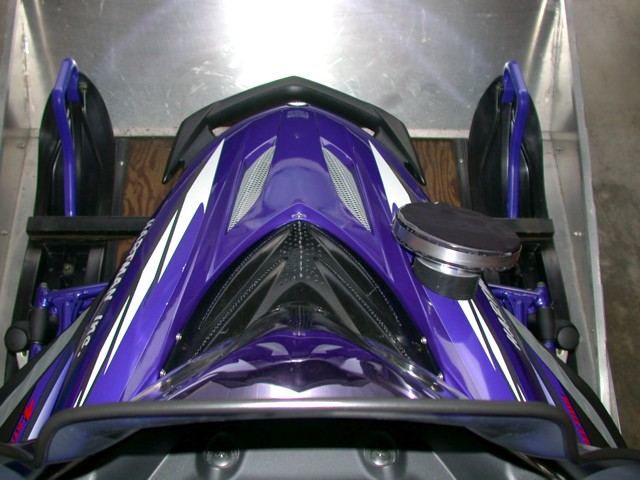

I cut the top out of my airbox lid to fill the open space in the hood that replacing the airbox with the SC system leaves... I do like the stealthy look and the way it seals up factory tight around the headlight... It will definitely keep the engine bay from packing with that early season dry powder... There should be plenty of air flowing under the hood with the existing factory side vents and the twelve 1" vents I added to the nose cone... The only problem I see with the modified airbox lid is that it restricts airflow "through" the intercooler core... Air moving all around it but none "through" it... Didn't work exactly the way I thought it would... There is some space available under the intercooler for a fan, that way I could draw the air that is available "through" the intercooler core... Anyway, cutting out that lid was a flippen pain in the azz... Started with a hacksaw blade in one of those little blade holders after bending two blades I was getting irritable so I grabbed a box cutter deeply etched along the lines I wanted then snapped off the pieces... The plastic is that hard and brittle... If you do attempt the box cutter course of action be very careful not to cut yourself or crack/snap off more of the airbox than you intend to... I cleaned up and smoothed the edges with a file and some sand paper... I then installed the hood and lid piece on the sled then duct taped them together to hold the two pieces in place... I removed them as one piece and marked where I was going to drill the holes for the hardware... Removed the tape and drilled the holes... I used some #8 stainless screws/washers/nylocks to fasten the two pieces together... Not a masterpiece of engineering but it will work...

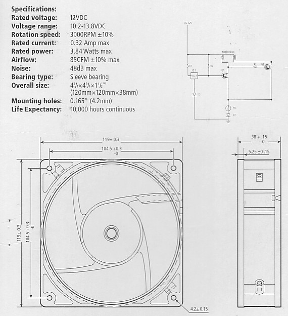

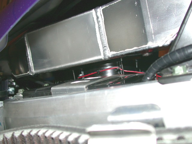

Installed a intercooler fan... It was a real-real tight fit but it works... Just wish it were a little more powerful... Still, it pulls air through the intercooler pretty good and blows down across the SC housing... All in all I think it was worth the effort... I bought a cheap fan at Radio Shack in case I change my mind an end up tossing it in the trash (see specs attached), Tranny Cooler mounting kit at Napa, and tapped into the factory accessory outlet wiring, which is already fused, for engine on power... While I was a Napa I also picked up a Raytech MT4 infrared thermometer with laser point targeting so I can take various temps (Engine, Intercooler, SC fluid, SC housing, Coolant temps, Clutches, and whatever else I can think of while I'm out testing.

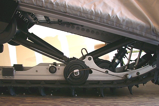

22-40 gearing (65-70mph track speed, a little hard on belts/clutches, easily attains full shift)
Removed the 12 UNI-filters I had installed in nose cap (SC fluid would overheat with them in)
Front straps in skid 2-holes tighter (steers a bit aggressive off-throttle but it's better for climbing)
Set rear skid springs to hard position and added Yamaha anti-bottom rollers to the rails
Transfer rods set to full rear transfer
Tighten & Adjusted track according to Yamaha specs AFTER making suspension adjustments
Trimmed muffler tub lip under tunnel so track lugs wouldn't catch on it at full "tail" compression
Front Shocks 8-turns tighter (10mm)
