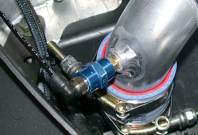

My little project: ;)!
To introduce some "liquid cooling agent" to my intercooler and reduce heat soak on long pulls.
Intended use: 7hp (.012 funnel jet) "dry shot" above 7000ft elevations.
Bottle Duration: 10oz bottle x .012 funnel jet = 60 seconds button time (6x10sec or 12x5sec)
PARTS LIST:
PINGLE (www.pingelonline.com)
(1) Pingle 7/8" Two-Piece Billet Momentary Push Button Switch (part# 668)
HOLLEY / NOS (www.holley.com)
(1) 10oz Nitrous Bottle 15 1/4" x 2" (14700NOS)
(1) Power shot Solenoid (16020NOS)
(1) 4AN Female x 1/8" NPT Male 90° Swivel Filter (17984NOS)
(1) 1/8" NPT to 1/8" NPT Female-to-Female coupling (991001ERL)
(1) Funnel Jet (13755-12NOS) (13755-14NOS) (13755-16NOS)
(1) Nozzle (13655-SNOS)
BoonDockers (www.boondockers.com)
20lb refill station
(1) 3 foot length of 1/8" Poly Line
(1) 90° push-to-fit poly line connector
(1) Straight push-to-fit poly line connector
SUPPLIES ON HAND
10 AMP Relay
10 AMP Fuse & Holder
2" Clamps (Bottle)
1/8" x 3/4" Aluminum Strap To Fabricate Bottle Bracket
Miscellaneous crimp connectors and wire

Hammer did you notice a diffrence from this setup?Why didnt you go with a bigger botle?How much did it cost you to put this all together and do they make a complete kit ? thanks alot if its succesfull i ouldnt mind tryign this on my mcx turbo

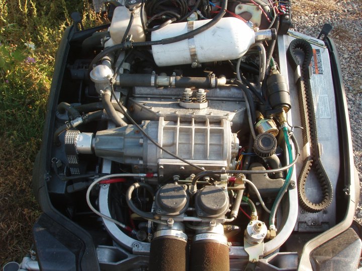

Here is extreme Thunder Spray. This is taking Supercharging and Nitrous to the edge. This is my test sled that has 20#'s boost and 100hp of our own wet spray with a progressive controller. From mild to wild depends on how western you want to get. I keep reading that superchargers can't keep up with turbo's. What do you think?? :nos By the way Hammer, Nice Job.

Here is my hood setup.

Filter Materials??
Hey Bossman, what did you use for a filter behind the air box vents you cut in? I was thinking of doing a mod where the holes are where you put them, but going larger and modifying the horns to adapt up four pod type filters. Could it be done, or is it a waste of my time. Also do you find the air box filling up with snow consistantly? Should a guy get rid of the box and just use air pods? Any thoughts would be appreciated !! Rock On !
