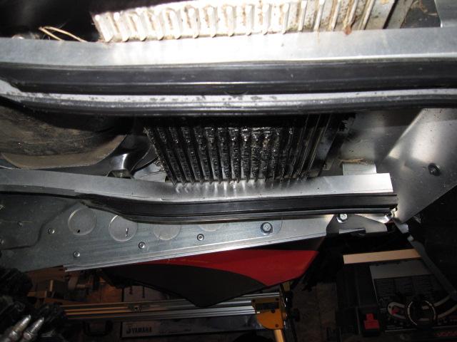

CaptCaper said:I'll have to go the 1 1/2 inches. A guy with a 09
Apex LTX with OEM cooler (same setup as our 2010 RS LTX I believe) had to go 1 1/2 in. before it stopped ripping up the cooler. I did only about 1" the first time on my Attak and hit the cooler so I did 1 1/2 and it has been fine. So either an aftermarket set up like mine or a OEM we still need 1 1/2 over cooler tappering down to the rear of the upper wheels.
Can you post a pic on yours so we are clear how the fix looks?

Is that on a Vector LTX?? Mine had the tubes going over the cooler in the back, it was just too close and we had to add an 1/8 more.

no these were on a Apex I believe and it was a aftermarket cooler before Yami did OEM installs of the cooler. I didn't do my RS LTX yet but I did do my 07 Attak similar and thought these might help someone who has to fabricate some extra protection and give them an idea how.
The LTX Apex's even OEM installed coolers have to have 1 1/2 in of protection over cooler or 1.325's will hit. Apex short tracks are different in clearance I think.
The Vector LTX is the same now as the Apex LTX isn't it? You only put 1/8 and it hasn't hit the cooler?
When I stud our RS LTX I will post protection pictures.

I finally bought some stud's for my wifes 2010 RS Vector LTX and still not sure how much clearance is needed. Mr. Sled is claiming a 1/8 bar but othes have said more.
Is there anyone who can chime in? I'm inclined at this point to go with at least an old hyfax rivited to start based on some of the reading I've done here over the last couple of years.

After a few seasons on the 2010 LTX we have found that an 1/8" is not enough.... Even 1/4" looks like with the right tail landing would catch the fins. We added some old Hyfax to a 2010 Vector LTX and found the same problem on a 2008 Vector LTX. Here is the hyfax in place and the damage done to the fins.

Are you saying Mr.Sled this is going to be the first season trying old Hyfax ??? or the Hyfax still isn't enough?

CaptCaper said:Are you saying Mr.Sled this is going to be the first season trying old Hyfax ??? or the Hyfax still isn't enough?
1st season trying old hyfax.

If you didn't trash the cooler out with less....more will be better.
I have 1 1/2 on my ATTACK on top of a after market cooler which makes it even less room under there then yours and being I way 260 lbs or my track,cooler,etc. is still A1 with 8K on the sled.

I would like to install 108 double digger Woodys 1.325 studs using the 136 center belt pattern to my 2012 Vector LTX.
What modifications if any are needed to the stock tunnel protectors for the 2012 model year Vector LTX?

You need to add more protection to the back area by the rear heat exchanger as shown :

I'm going to do that today to ours.. hope it's enough..

I picked up a 2009 Vector LTX GT, pristine, only 98 miles. It is studded, but I do not know the length of the studs used. Safe to assume I need to install extra protection on the 2009 as well? Thanks.

If the exchanger looks like the picture in this thread, I would say yes.
