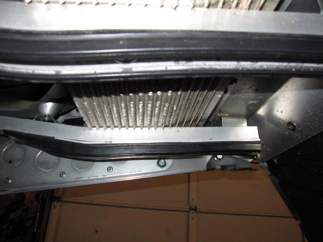

I have about 1 foot of Hyfax added to my 2012 Vector LTX as well but my studs have a couple good gouges in my rad fins. How thick are these rads after the fins start? Should i be worrried about a leak?
[/img]
[/img]
[/img]

After looking at this again it looks like the dealer didn't install the hyfax ahead far enough.
[/img]

You need at least 1 1/2 inches. Hyfax alone isn't enough. Take some Aluminum tubing or strips and make the difference up over the cooler and taper to the back of the upper wheels. Don't go any further then the back of the wheels. My wifes LTX Vector has this with 162 1.325 Woody's and never hit. Same goes for my Attak.
Lot's of guys here have had this issue. This is how I learned to put the 1 1/2in.

The Hyfax did their job to protect the major portion of the rad, the back section of the rad. You don't think if I just extended them up to the upper wheels that wouldn't do it? I'm just not sure how i go about added to the hyfax that is there now.
