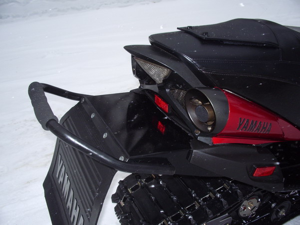

i changed the gearing to a 24-40,i already had the 40 gear and i think the bigger gears work better than going smaller even though the ration is about the same,dont really have to machine the clutches but the secondary spring binds so you at least have to put 3 small washers on the studs that the helix bolts onto to prevent this, pic of my air box mod ,not sure if it makes as much difference as the cut top section but more air is better,it all depends on what you like,if you like 0-100 and dont care about gas mileage stud it up and clutch it up and hang on,i like top end and gas mileage so i make the clutches load the motor and you can pull me from 0-100 but you wont hang on top,this year i went to a 13.5x128x1" hacksaw,i think it works better than the ripsaw so far seeing 130 on dreameter the other night and i couldnt hold it cause the snow falling at the time was blinding me ,shooting for 140 this year on dreameter,i seen 139 on my 03rx1(ideal rrbed conditions) but 134 is best on the 06rtx so far,any questions let me know ,im no expert but i know what ive done to this one
