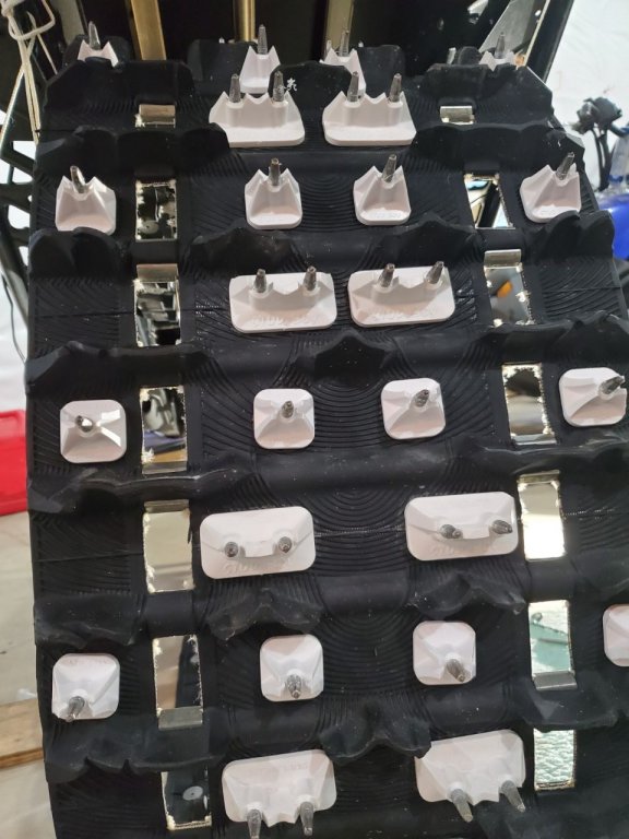

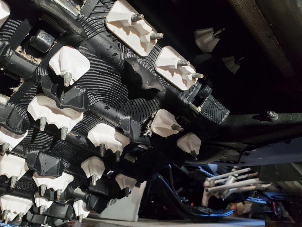

Well I fell victim to poor trail conditions over the weekend or at least my single Pro Lite backers did. Out for the very first time after countless hours of maintenance over the past few months and even while taking it easy through the bad spots in the trails i still lost 2 middle single Pro Lites. None of the outside singles pulled and i know they made solid contact with the rocks and roots we were creeping through because there were some that had spun and it took allot of force to spin them back. Absolutely love how these things hook when on hard pack, but now i am second guessing using the singles on a replacement track since this track now has two extra windows! I could never get the sled to hook until going with studs on the outside so i have a dilemma. I removed the 192 1.57" megabites and reinstalled them with doubles and single Pro Lites. The pic show the first one that tore a square in the track the same size as the backer and the second stud left a perfect window the size of the backer. The track has 4500 miles on it almost all tuned. Now What?

4500 miles on a tuned track that has been compromised = Time for a new track
OH yeah, for sure. Just wondering how many guys have had issues with the single Pro Lite backers.
Maybe if SnoCross or a lake runner those plastic backers work but on trail I never made a ride without breaking one.

Never used the pro lite. I would chalk this up to early season/no snow conditions.. Woodys gold diggers on all mine for years
I had the exact same stud pattern(used the same holes) with the extra large snow stud backers and the Mega Bites for 3 plus seasons with only 2 bent studs. The traction was better with the Pro Lites and Shedding the weight was really nice. Would like to have studs on the outside and not just up the middle, but not sure it's an option with these. Was thinking adding 2 singles outside with a double in the middle every other bar and 2 doubles on the others. I think there's enough deflection outside for them not to pull, but i don't want to tempt fate on a new track after seeing how those took squares out of the track with them.

I am not sure how many miles you are expecting out of a track on one of these sleds. 4500 is about right if you ride hard and ride in bad conditions. I change my tracks out every 5-7000kms. Usually every season. Everyone I know that tries to push the life on one of these tracks ends up with a pullthru mid season, often with a stud in a heat exchanger.
I realize the track is long in the tooth and i have zero issues replacing it. Just wondering if i would be in the same boat had the track been brand new at the time.

Well I fell victim to poor trail conditions over the weekend or at least my single Pro Lite backers did. Out for the very first time after countless hours of maintenance over the past few months and even while taking it easy through the bad spots in the trails i still lost 2 middle single Pro Lites. None of the outside singles pulled and i know they made solid contact with the rocks and roots we were creeping through because there were some that had spun and it took allot of force to spin them back. Absolutely love how these things hook when on hard pack, but now i am second guessing using the singles on a replacement track since this track now has two extra windows! I could never get the sled to hook until going with studs on the outside so i have a dilemma. I removed the 192 1.57" megabites and reinstalled them with doubles and single Pro Lites. The pic show the first one that tore a square in the track the same size as the backer and the second stud left a perfect window the size of the backer. The track has 4500 miles on it almost all tuned. Now What?View attachment 159160

Decided I would go with 192 Mega bites 1.575" with all Pro Lite double backers up the middle and maybe add to the outside with singles after the fact if it's not satisfactory.
