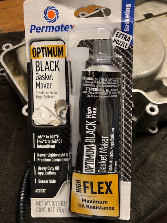

The Optimum Black I used works amazing....when i had to open/remove chaincase after I had sealed it, it was so tightly sealed I couldn't open it! I actually had to use a pry bar to get it open....tough stuff!ultra black seems to work. we have tried blue and Yamaha bond with no luck. finally at the end of the season we tried the ultra black on one of the machines that was leaking badly. so far no leaks
The key factor is good clean surfaces, then allowing it to set up abit before pressing the cover on too tightly, which pushing most of the silicone outward, and IMO this is why they all leak, as they are put together too fast at factory and too much pushes out.
I mated the surface so silicone touches each case, hand tightened bolts lightly.....let it sit well over and hour allowing the silicone to thicken, before torquing down.
This is same as ultra black but is aimed at lightweight components(IE: Magnesium)

Hey Dan, funny you should post that - I just finished using that exact product to fix my oil tank seal.
Wasn't planning on it, but after a really hot week there was a puddle of oil under the sled and the oil level had dropped on the indicator.
Good news - I was about to change the oils anyway.
Bad news - pretty pathetic a new sled with only 2600km needs to have this done.
After taking it apart that old gasket was so thin it was a joke. Using gas to clean things up it virtually dissolved the gasket the minute gas hit it.
As for the Optimum Black - I agree with you. The key is to make the bolts snug and allow it to set then torque down after 60-80 min. Didn't bother using Loctite on the bolts (defeats the purpose if you crack it an hour later after it sets). The fasteners they used are not normal threaded bolts, they look like more of a machined screw.
Hope it all works out.

I would say initially don't use loctite, but once the seal has had a chance to firm up you can put some loctite on the bolts before you torque them down.
Dan
View attachment 148926 View attachment 148927
