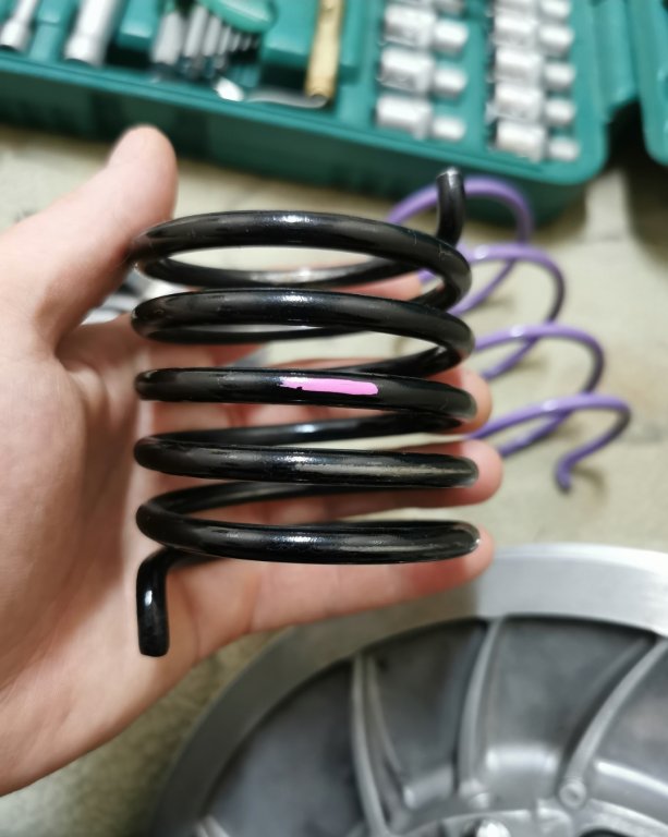

Like Knapp pointed out that RPM was recall RPM that doesn't mean anything due to it's lack of accuracy. I have never used the feature so I had no idea it was useless. The problem here is that Purple spring is just too much spring for a full stock set up. It's going to increase tension too much and make heat. For comparison the stock spring rate is 37.4 / 118.8 lbs. He's already loading the motor up riding in deep powder and from what i see unless he cleaned the sheaves the primary is holding the belt if not for a tiny bit of slippage at engagement.
Yamarus If you don't have access to a spring that's better suited for the application like a Dalton Black/Orange or a Cat Red/White then put more wrap on the stock spring. Just note that those Yamaha springs do break so don't go crazy with it. You could also try a little less angle on the helix, but again I'm not sure how it is getting these items where you are located

Can you please tell me the part number for the Arctic Cat Red/White spring?Cat Red/White then put more wrap on the stock spring. Just note that those Yamaha springs do break so don't go crazy with it.

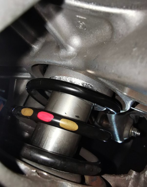

I'll be installing a stock spring on the secondary clutch this weekend. What setting would you recommend, 3-3, 1-6, 2-6? Thank you.
Anything beyond the stock 3-3 and it will could bind. If you run the pink secondary spring, it is already coil binding even on that 3-3 setting.

A stock yellow spring that came in the 17's is a bit stiffer than the pink they put in them in the later years. The 17 had the best stock clutching in the secondary with stock 35 and yellow set at 60.
When they went to the lousy 35-39 reverse helix in the later years and the pink spring it was really messed up IMO and the sled slowed down in stock trim. They would over down low and pull down too far up top, backwards of what worked well, but the clutching and belts ran cooler because of the lighter secondary spring. If only they would have fixed the offset and locked down the secondary that would have done a better job.

Any of the Viper or Nytro springs will interchange.Unfortunately, these sleds are not common in our country. Therefore, we have to look for spare parts. A lot has to be ordered from other countries, and the wait is very long.
There are many parts from Arctic Cat, Viper, Nytro. But it's unclear what part numbers fit the Sidewinder.
In addition, if you wanted to switch the secondary rollers out for something that won't ruin the helix over time, the Cat secondary rollers fit.

Yep, pink.
I set the tension to 1-6. I'll be monitoring the temperature and the belt again this weekend.
Like I said, the pink binds already at 60 degrees, so setting it at 70 its really going to bind at full travel. Don't be surprised if you pop another belt at high speed. Especially if you are still geared down. When you limit the travel on the secondary, and the primary keeps pulling belts pop.
