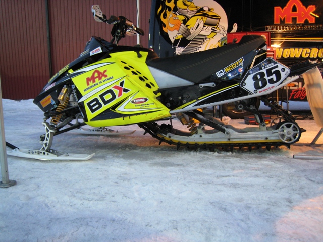

Maybe little bit off topic, but if you are looking for a longer center swingarm you need to take a closer look at the Lynx PPS rear suspension. No matter what their commercial material says, in my opinion, the advantage of the extremely long center swingarm in this particular position and angle is that you get a weight transfer that is very easy to control with your body position. Lean forward and the sled exits corners with the skis glued to the ground. Lean backwards and it wheelies like there is no tomorrow...
Evil rumours in the snocross business suggest that the R-Motion is Ski-Doo's effort to copy the PPS suspension, at least from a shock absorber progression point of view. I have never measured one so I can not confirm this.
