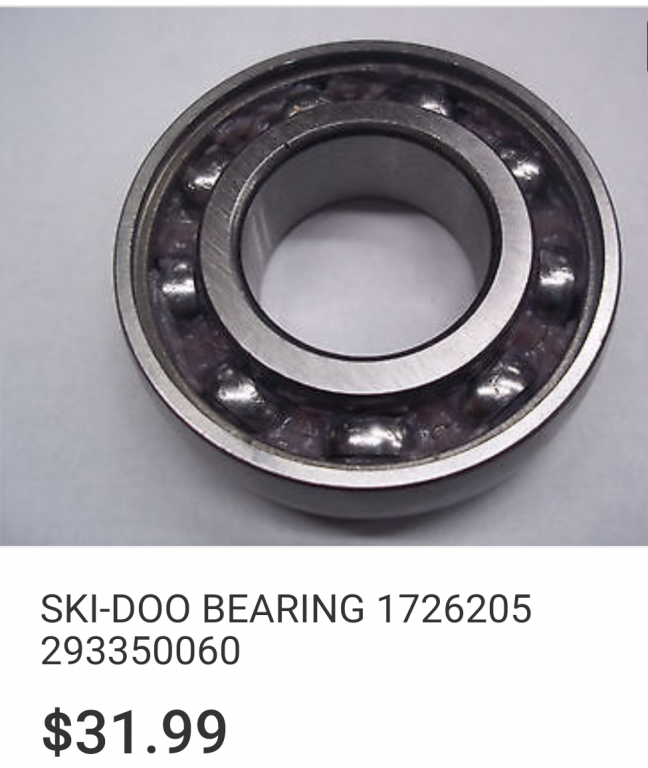

Oh yeah...lol...I don't think my ski doos had set screws...can't remember. I did find this because I like to learn stuff..For this reason. Has to be since the little set screws really wouldnt do anything for any sideloads. Stains idea is a great one. Eliminates possibility of some Dick tightening the crap out of a set screw buggering up shaft and making bearing removal a bugger. Ever seen that with the old style set screw style? or how about stripped little allen screw? You guys all seem to have a short memory for all the little problems we all dealt with on our old Yamahas. I still say this sled has least maintenance in hrs of any Yamaha I ever worked on and rides a hell of alot better!
